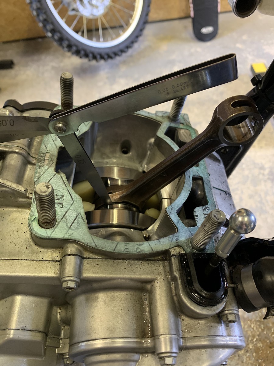

Measured the side to side play in the conrod it came out at 0.75, have i just found the problem?
That noise sounds like a bad rod bearing or main bearing to me. Has the bottom end ever been apart? How many hours on it?
Find out the big end side clearance service limit and go from there
Never split lower cases before so trying to get it booked into a workshop now i think its rod or main bearings i dont think it can be anything else now tbh

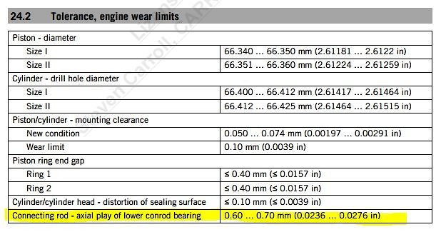

This is from my 2021 KTM 250sx service manual...
0.60 - 0.70mm
Appreciated
Time to split the cases
