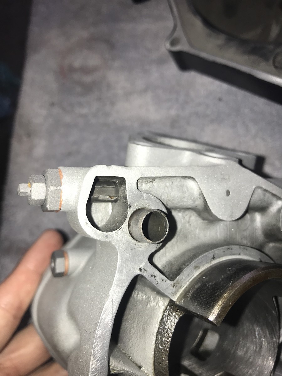

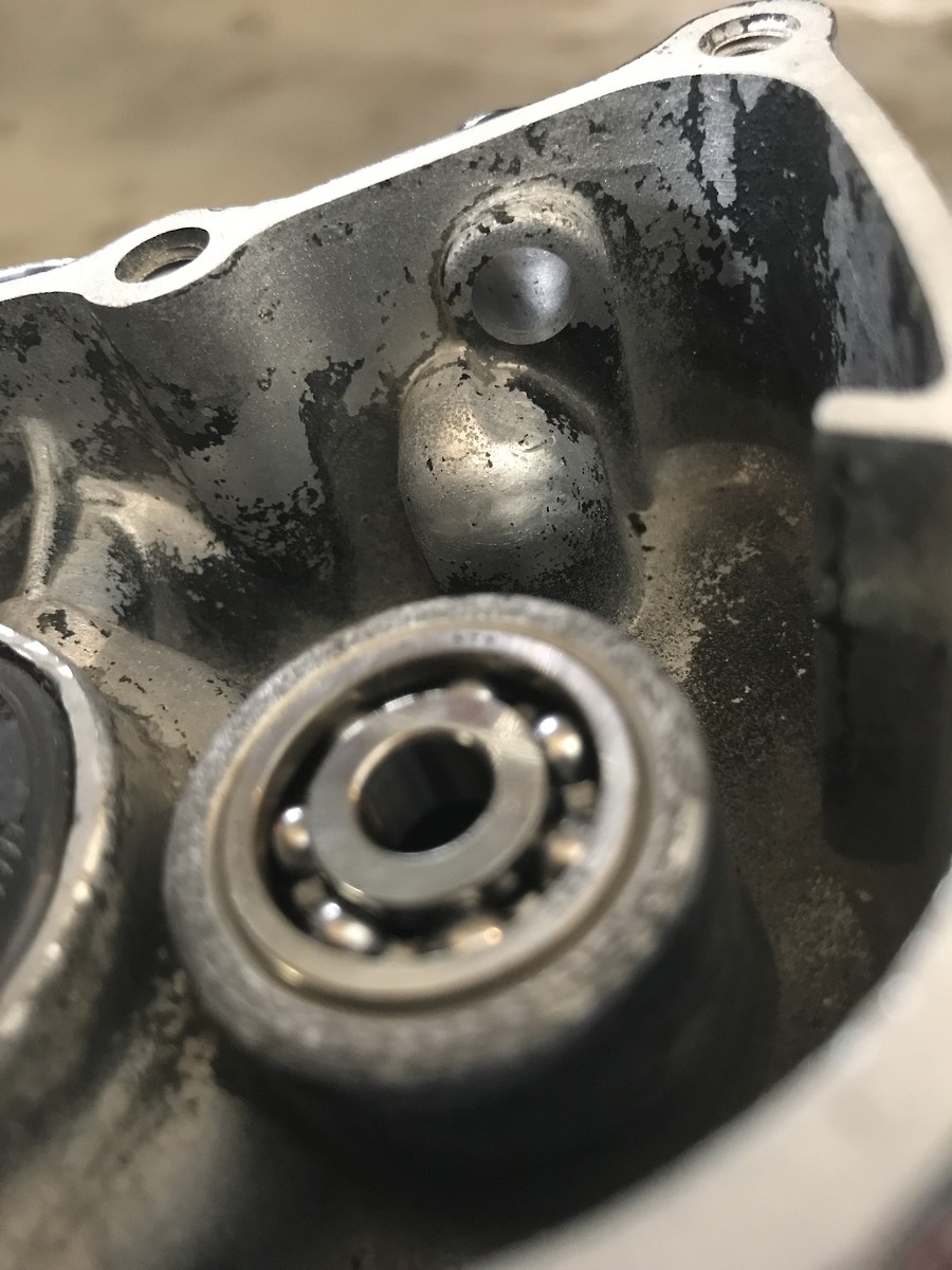

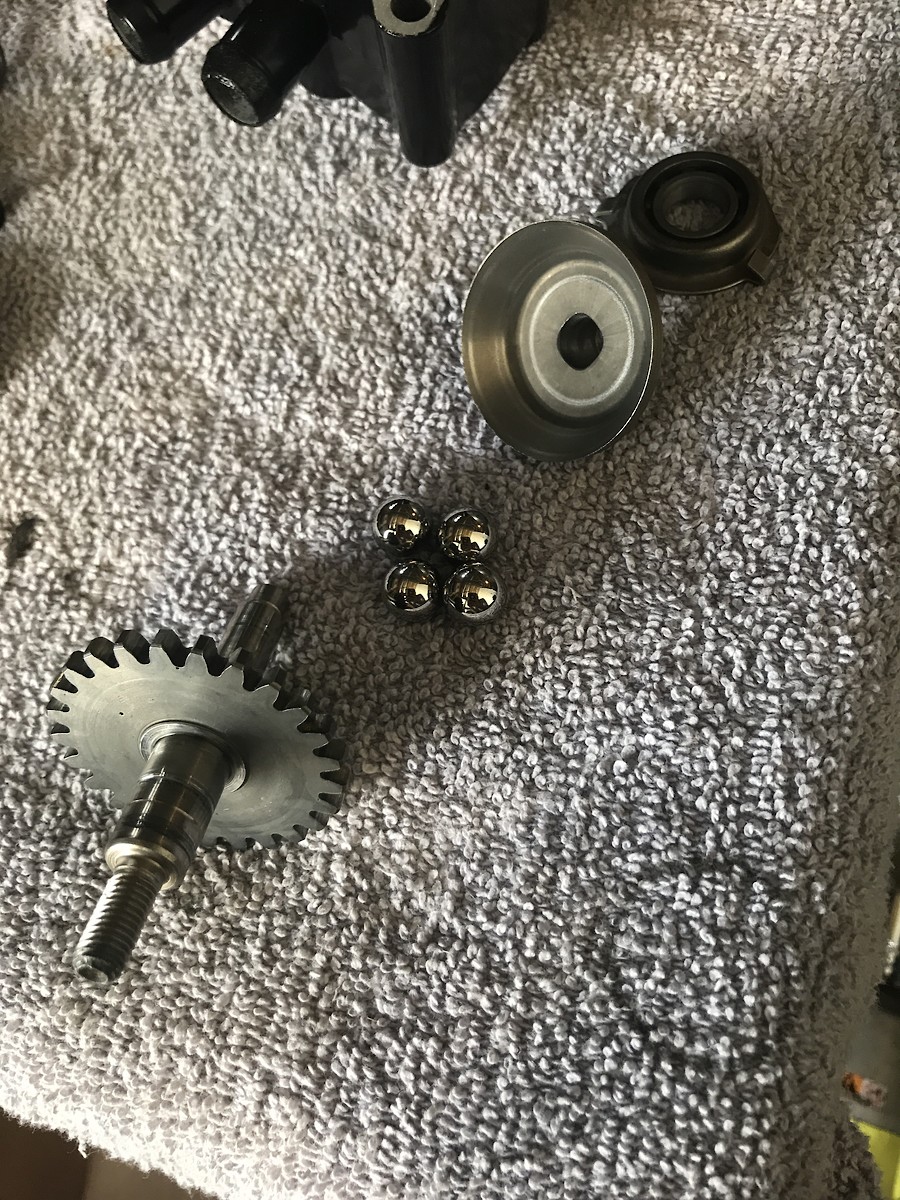

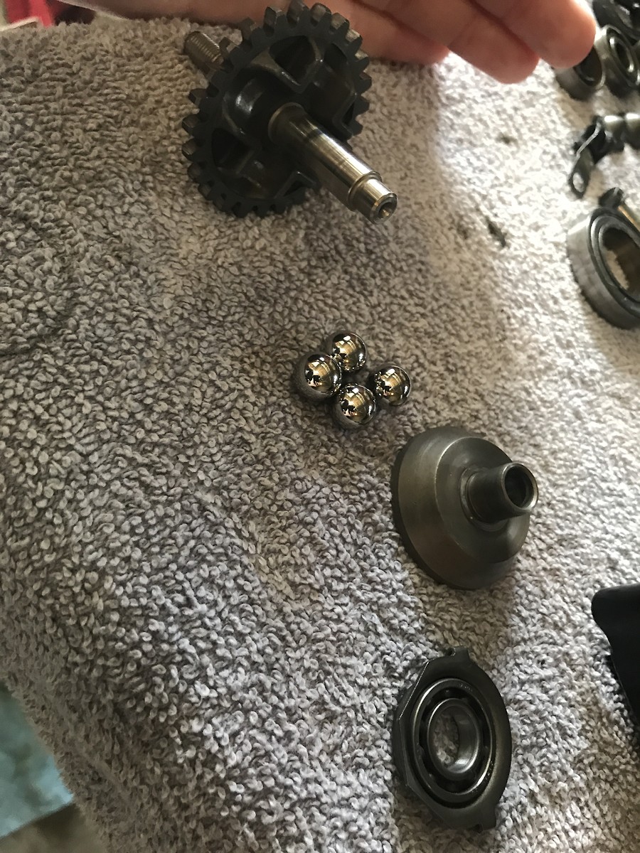

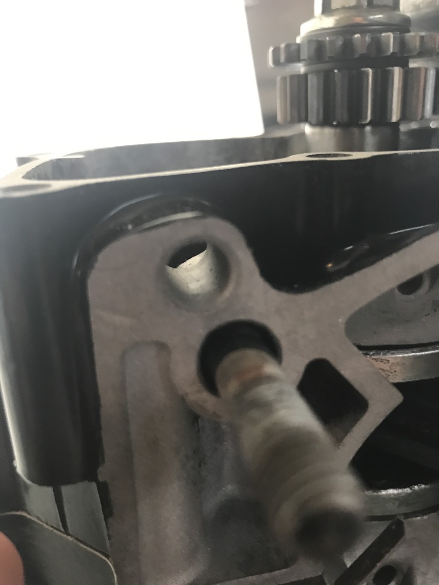

So I have a 1984 cr80 that is very close to being finished with the rebuild. I’m currently installing the water pump assembly then will be putting the new clutch in and the engine cover. While looking at the diagram and parts, I finally realized how strange this water pump assembly is and when I installed it exactly like the diagram it just doesn’t seem right at all. If you look there’s the bearing sitting inside the engine case, then I put another bearing on top that’s sitting in some cup? Then a cup with four metal balls and a gear? The second bearing just slops up and down with no real intention and everything else leading up to the gear. Also I notice a hole in the engine case right above it which I believe all connects it to the atac system in the cylinder? But I have a pro circuit pipe with the atac deleted. Would I need to modify the water pump assembly and cylinder in any way because of this? Sorry for the confusing post I’ve just never seen anything like this and I’m very confused. I want to delete the entire atac system on my bike. What do I need to do in order to do this and how should I have my water pump?

Isn’t that actually the governor you are showing?

The two pics are parts of the water pump and the last 3 are showing the hole and the cylinder
I see the same thing.

After looking more at the parts diagram you’re right. I’ve never seen a governor before, I assumed it was part of the water pump since it’s all connected on the water pump shaft. What does the governor do exactly? Limit too speed? Is it connected in any way to the atac system? Is there a rod supposed to connect it to the cylinder in any way (as seen with the hole on the crankcase)?

Why should it be good to delete the ATAC system? It makes the engine more userfriendly, should give more torque down low without costing any power in the upper revs. The governor "steers" the ATAC system. By chosing different springs and/or balls you could play around how the system performs.
If you leave everything out of the system you will still need the shaft and pinion that drives the waterpump. Lock the power valve in the open position and try the bike but expect to use the clutch a lot more.
