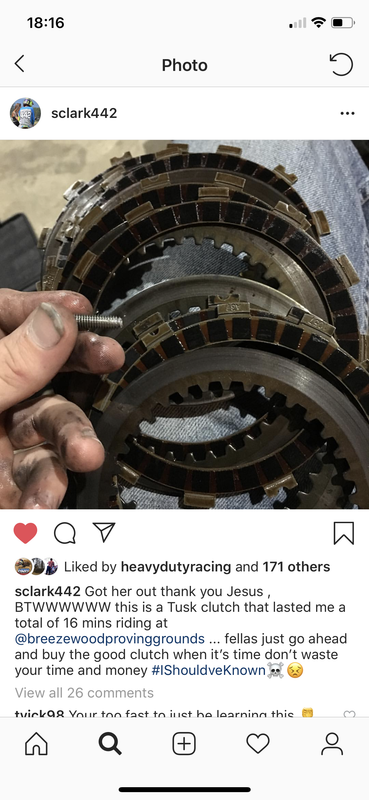

Granted this guy finished 38th at Budds Creek last summer in the 450 class. But I would probably look elsewhere for a clutch.
