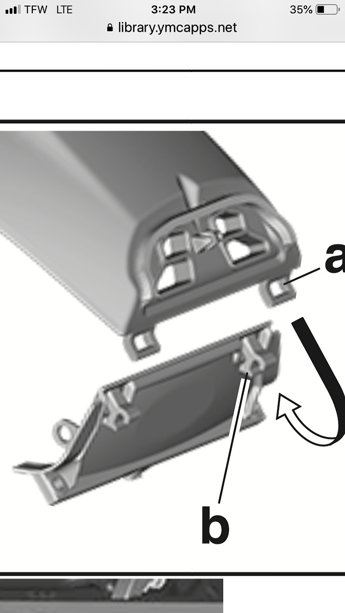

Yeah, the point of my post is that the air box / intake area is proving to be where the best bang for the buck seems to be coming from on the Yamaha's. Once you let them breath they start to come to life.
The parts I have shown here are the VHM parts, but there are other worthy options, although I'm not aware of anyone else making an air horn like they have.

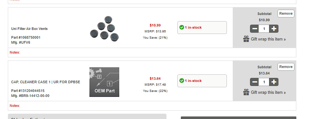

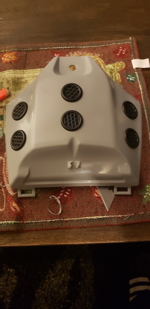

For those who want to build their own spare modified airbox to try, it's a ~ $25 purchase from Rocky Mountain ATV.
Here's what you need to buy (Uni Airbox vents + blue OEM airbox cover for 2020 YZ450F):
... and you'll end up with this (as described in another thread: https://www.vitalmx.com/forums/Tech-Help-Race-Shop,42/YZ250F-2019-air-b…):
mx317
4552
TN US
12/14/2020 1:26pm
2021 YZ250F has vents stock.
