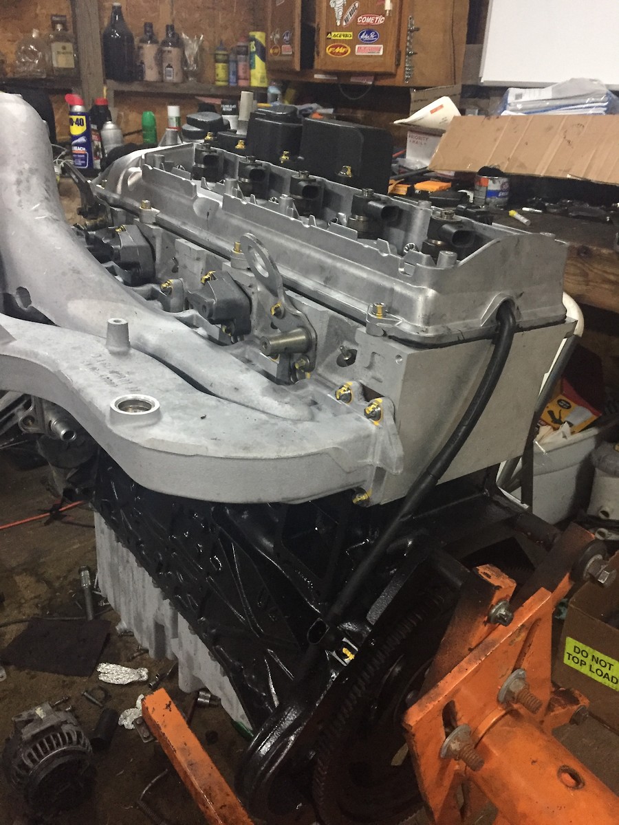

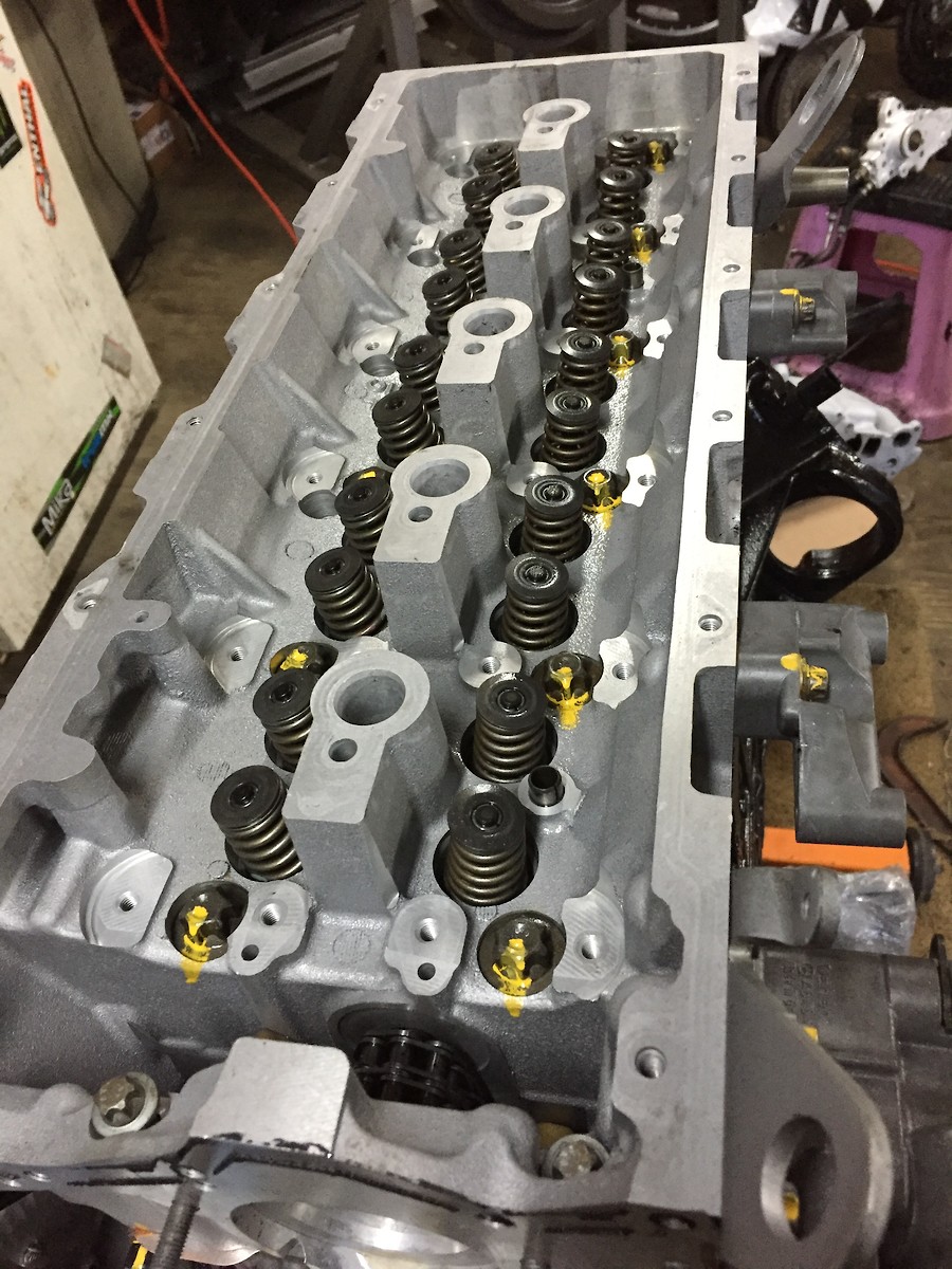

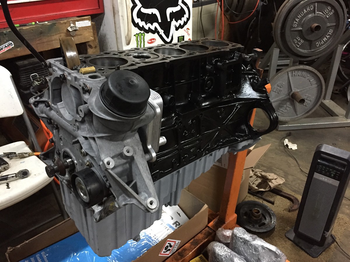

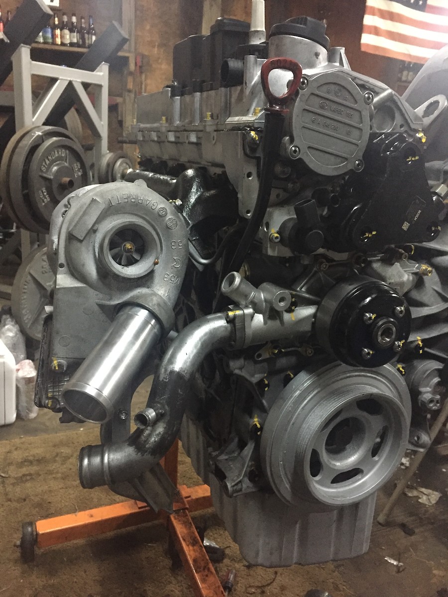

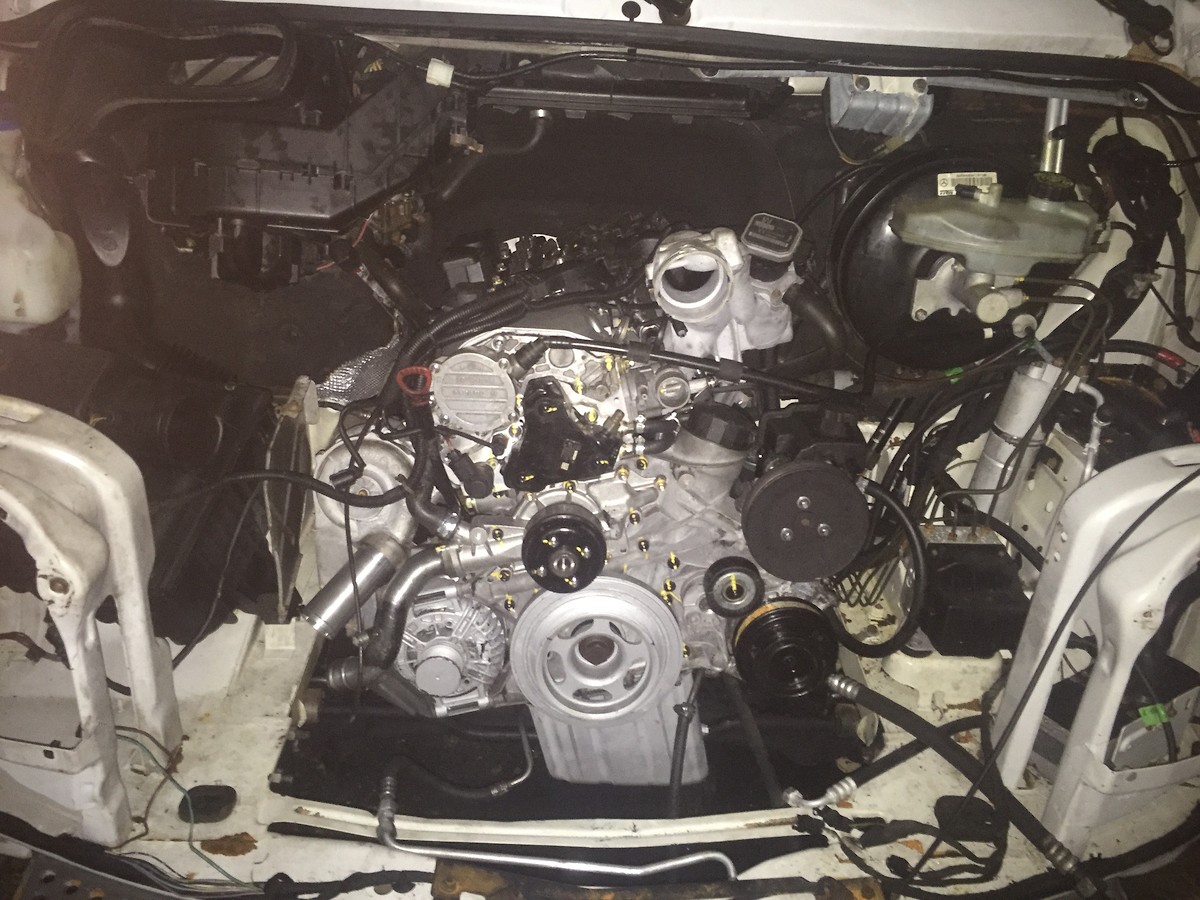

Yo man if you buy any mercedes van you have to instantly. invest into the injection area of the head 1800$ to do it right. i have two 2006 vans and just rebuilt the motor on mine, im serious dude, do not fuck around with buying it then not purchasing new injector hold down bolts, crush washers and some other gasket stuff. This is not something where you can just go buy the van and use it like your local chevy express, if you want a 2006 sprinter you have to be willing to do maitenence religously, I will repeat my self once more so you understand, if you think maintaining a dirtbike is critical, that mercedes van you are about to purchase 2002 and up are more critical than mx bikes. Also there is a plastic peice in tbe tubo mercedes has revised it 7 times and still cant seem to figure it out, the fix is a cnc. machined aluminum wastgate barrel. Dont take this post lightly, or you will lose your 10k faster than going deep sea fishing in a hurricane.

Look up T1N black death! i had two T1N vans (2006 model mercedes that had that happen, here is a pic of the motor and wht it looked like when "black death" (leaking injector crush washers) occured.
