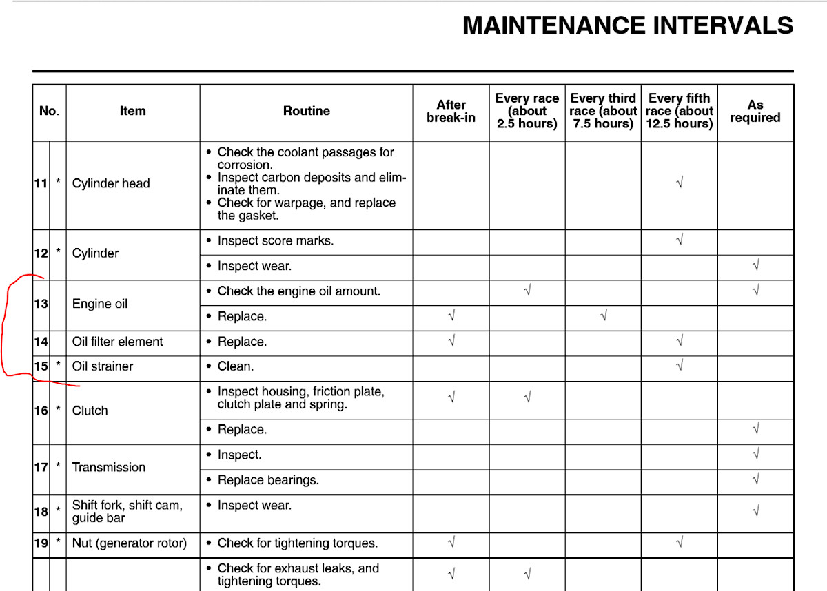

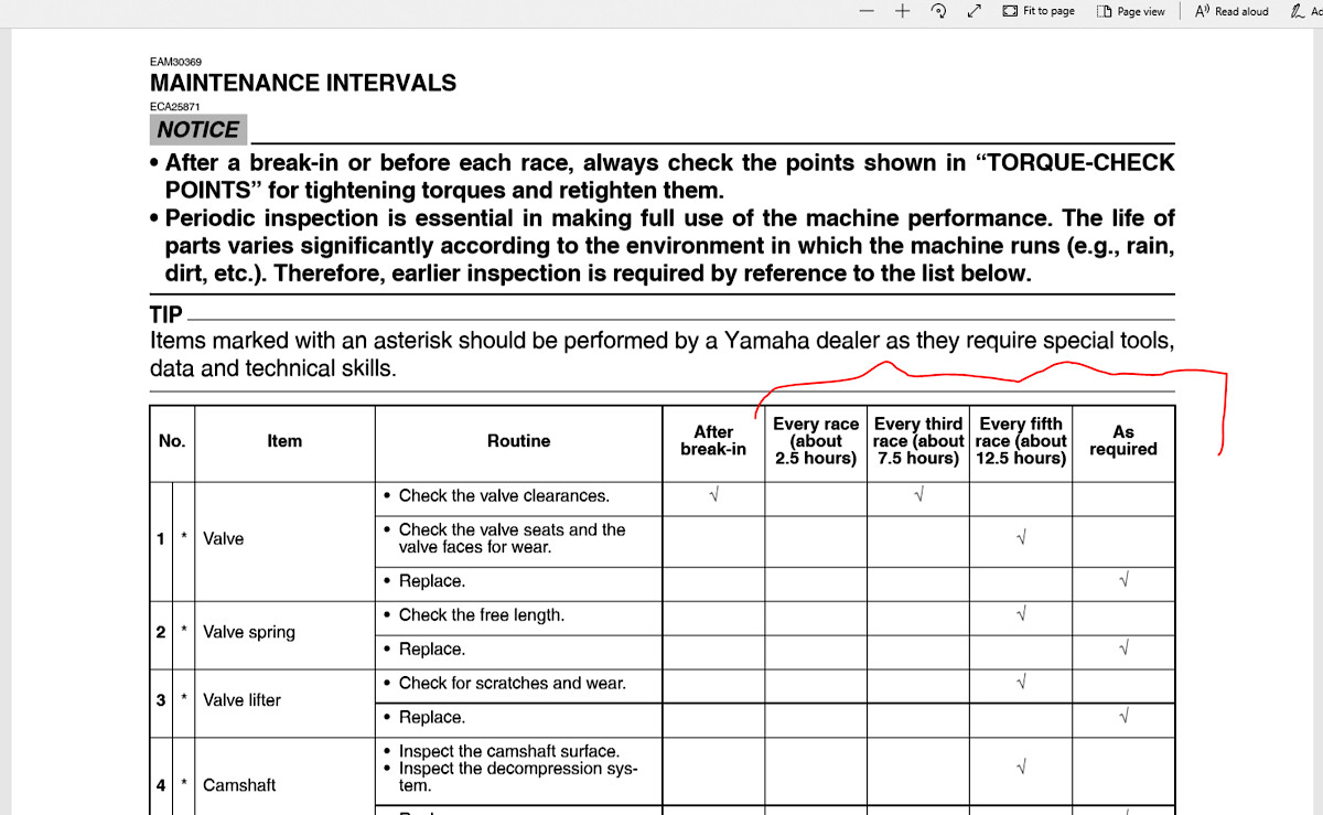

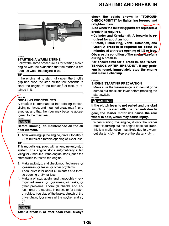

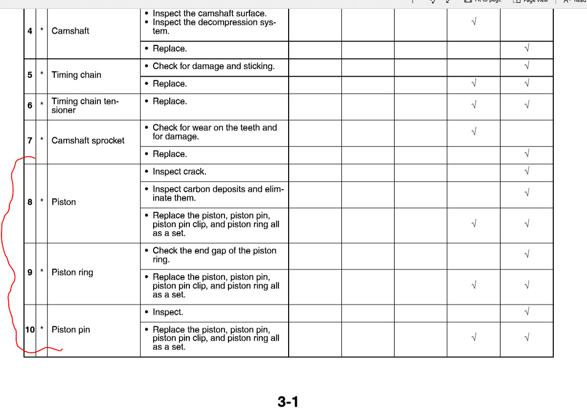

Here's what Yamaha recommends on the 2020 Yamaha YZ450F:

Rider 5280 wrote:
Here's what Yamaha recommends on the 2020 Yamaha YZ450F: [img]https://p.vitalmx.com/photos/forums/2020/11/25/461667/s1200_2020_YZ450F_Break_in_Procedure.jpg[/img]
How often does yamaha suggest you replace the piston on the 450?
Rider 5280
2014
11/9/2011
Denver Metro, CO US
11/27/2020 11:55am Edited Date/Time 11/27/2020 12:56pm
See below for the 2020 YZ450F.
