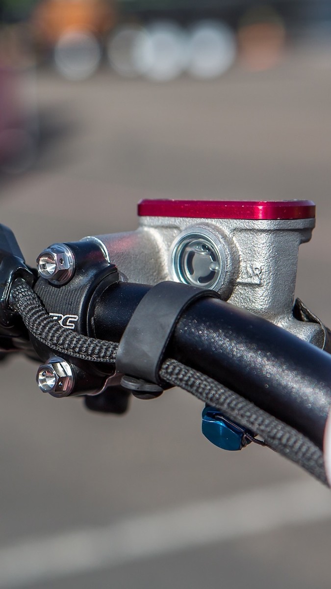

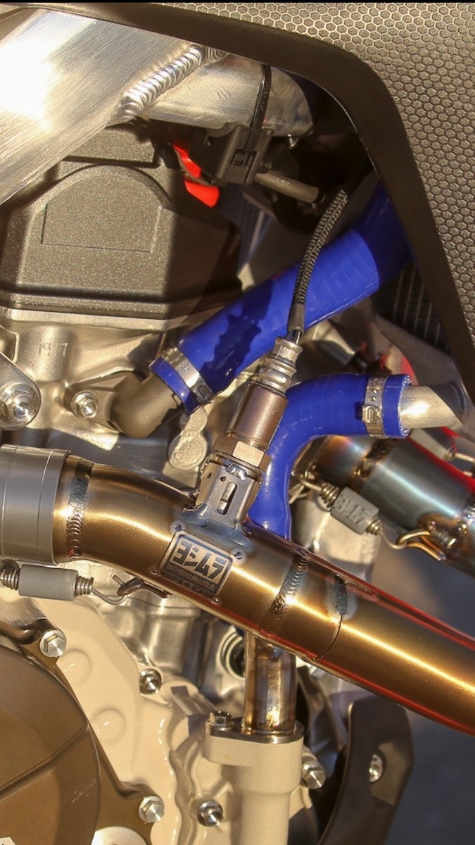

Anybody know where to get these, needed for a 19 Honda

Ducati uses that type of cable ties on their bikes.

Amazon

Sharing my KTM secret. The hose clamps are Pex clamps for home water piping, sold at Lowe’s or Home Depot, need Pex Crimp tool to crimp on, cost approx $60 in stores, I found good ones on amazon for $30

Oetiker clamps for the hose. I found a kit on Ebay that came with an assortment of clamps and the crimp tool.

This is where I bought mine, they have any size you could ever possibly want
https://www.atp4pneumatics.com/product/oetiker-167-clamps-7mm/

Hey OP, I know you asked about the crimp style clamps, but I wanted to throw out another idea.
These Gates Powerclamps are pretty cool and give a clean look. They act basically like a heavy duty shrink tube.
https://www.gates.com/us/en/fluid-power/engine-hose/hose-clamps-couplings/gates-powergrip-sb-clamp/p/p100748

Used the crimp clamps working on Sea doo jetskis where they are OEM and hated them

Looked into the Yates heat shrink clamps and they are interesting. They can be reused but you need a special tool to remove and stretch the material for reuse

I love the backup start button. Did the same on my 2018 450RX. All factory Honda race teams do the same
