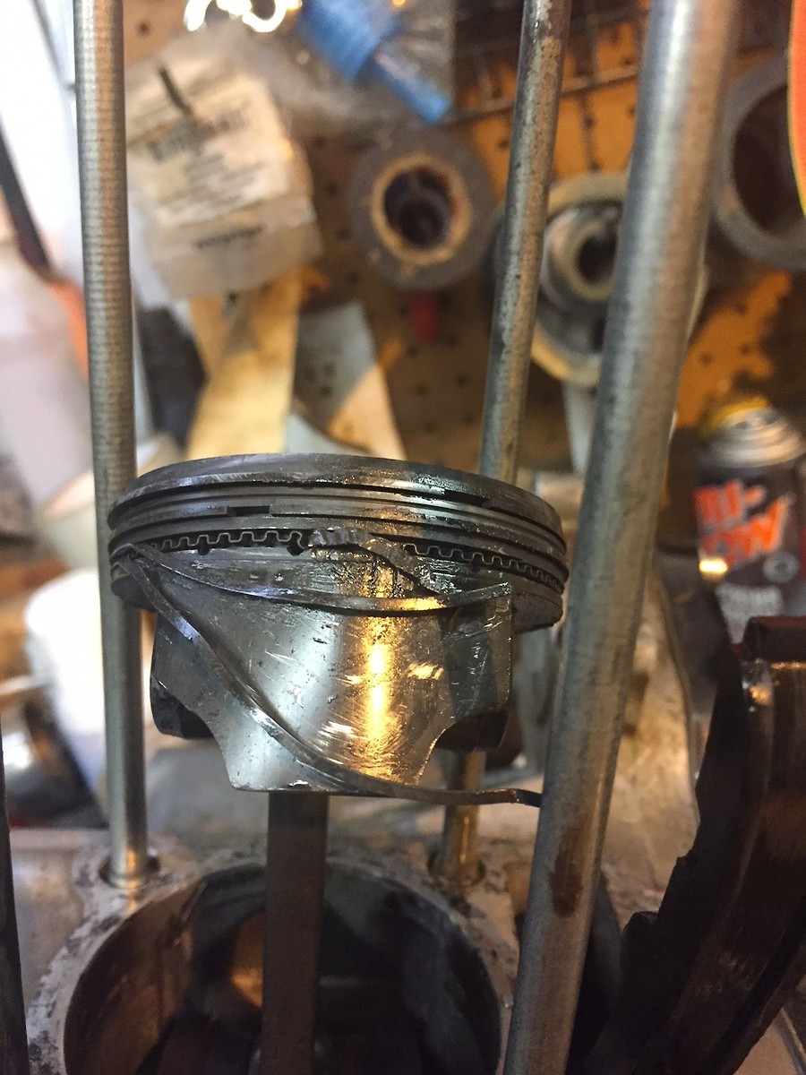

Read my piston-->

Wasn't running real well. Not sure why?--Any ideas?
Paw Paw 271

I am thinking Broke and used up.

Shit looks like its only got a couple hours on her. No idea why it would work. Hows the cylinder look?
Funny enough the cylinder isn't all that bad. It's a chinese big bore kit for a KLX110 so plating is toast as usual but other than that it didn't mess it up. Ran it without oil & dirty/no air filter from the looks of the tablespoon of mud I drained from it. Crank has no play and side play within spec but I am recommending full bottom & top rebuild. Friend bought it cheap from a kid who got it from a rich local guy who spent $$ on it................
