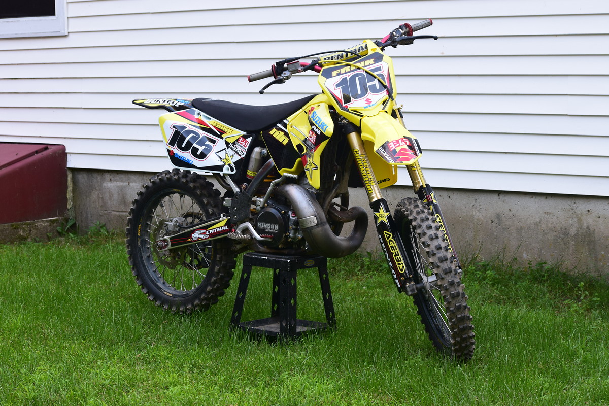

i modded some late model RMZ-450 pegs on my RM125.
[img]https://flic.kr/p/qFri17[/img]
7/14/2017 4:28 PM
PhotoNCM_0213 by bruceclapham, on Flickr

Those in the picture are torq1 steel pegs from a 2015 rmz450. I bought them, put them on my 450 and realizes they were cheap made in China product that didn't fit right.
They won't bolt straight up to the rm125, I just put them in and slowly filed the stopper until they sit at the right height. The post is 1mm shorter also, but you can shim that with a washer
