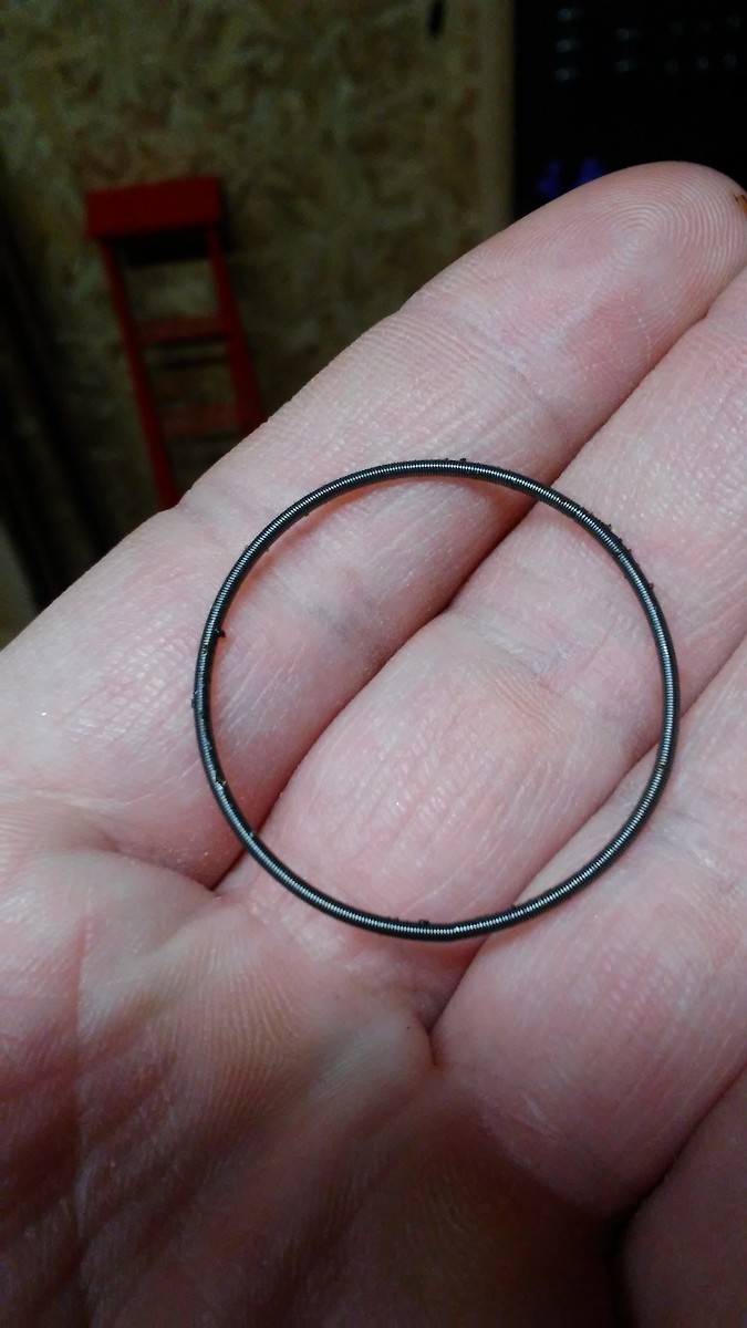

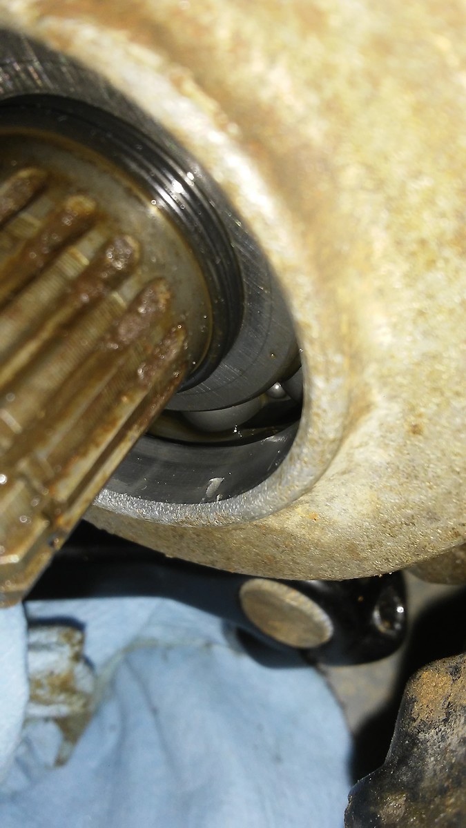

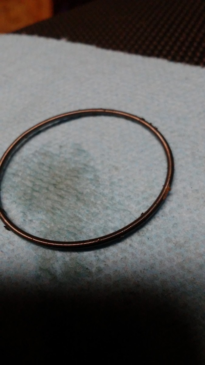

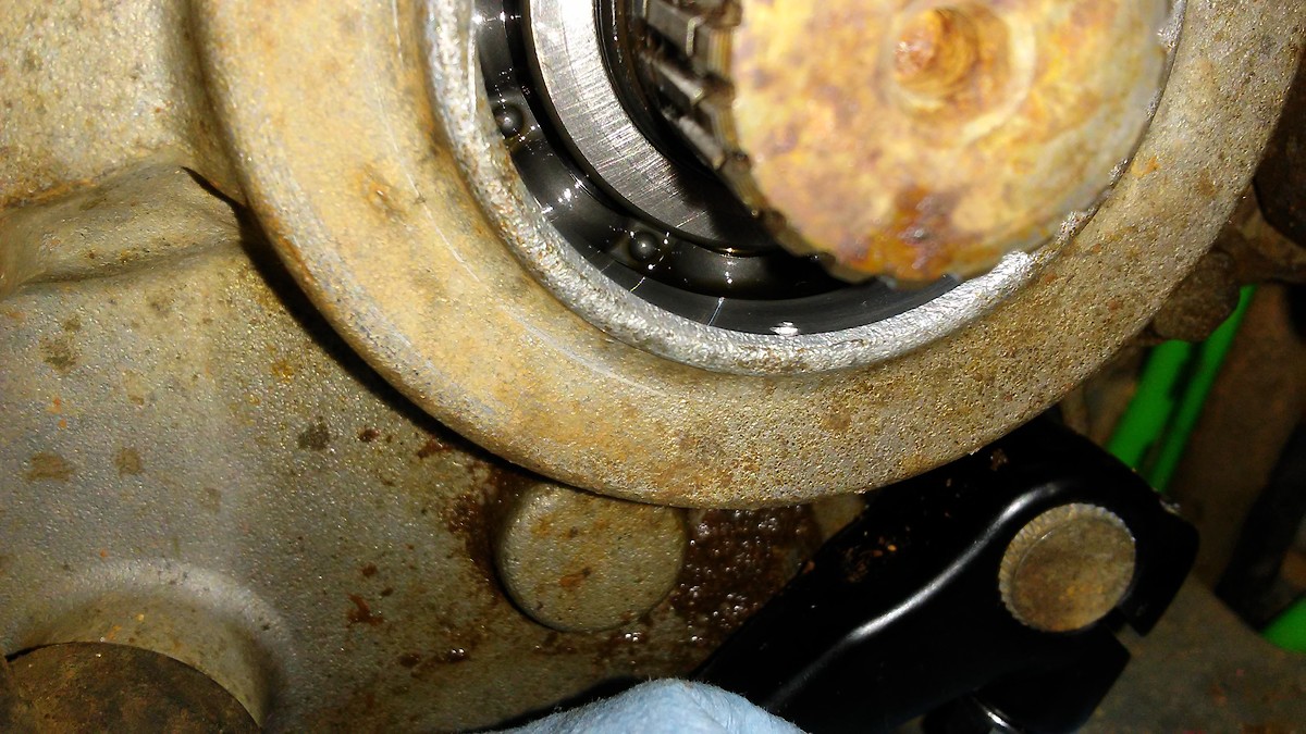

Since i have the bike apart I am going to replace the countershaft seal, I noticed 2 small chips on the inside of the housing just behind the seal, I am assuming from the previous owner using a screw driver or something to remove the seal. I dont think this is where its leaking but not sure if i should leave it or try and patch it? I know there is suppose to be O-rings on the back of the shaft but I pulled out a metal looking O-ring type think that I cant seam to find online, any ideas as to what this is? (I tried to post pictures but it keeps saying error)

That thing is the spring from inside the back of the seal it is what puts tension on the seal to make it work.

You have the two O-rings that sit on the output shaft where they should be. Paw Paw is correct about the piece in your hand...that's the tension spring from your seal. It's supposed to be on the seal itself. A new seal will come with one, and those chips in the case where the seal sits shouldn't cause a leak. They don't appear to be big enough. As for the clutch suddenly not working, no clue. Perhaps you could post up some pics of your clutch assembly?

thank you for the replies, I looked at the parts diagram and did not see that special o ring so thank you. The clutch set up is all stock, I ordered a complete clutch kit today so I hope that does it. I will post back results when I get it installed, Thanks again
