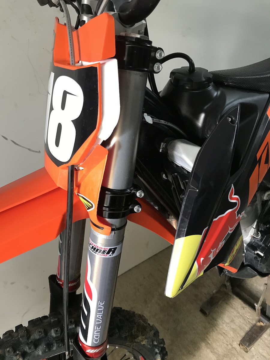

Had my WP Cone Valve out for Service/Rebuilt by a WP Service Center .
New 48 Springs , Cones , Cone Adapter , Seals , Sealholders new for 750€.

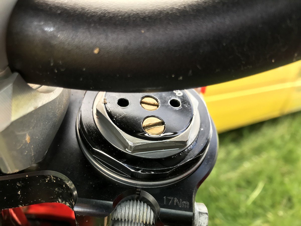

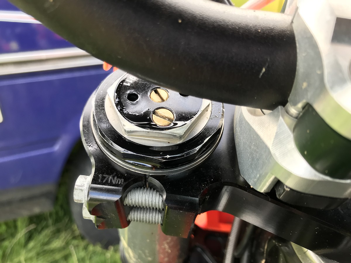

Last week after the first ride i notice oil leack on both sides
I thought it comes from the Bleeder Screw so i replace them but it wasn‘t.

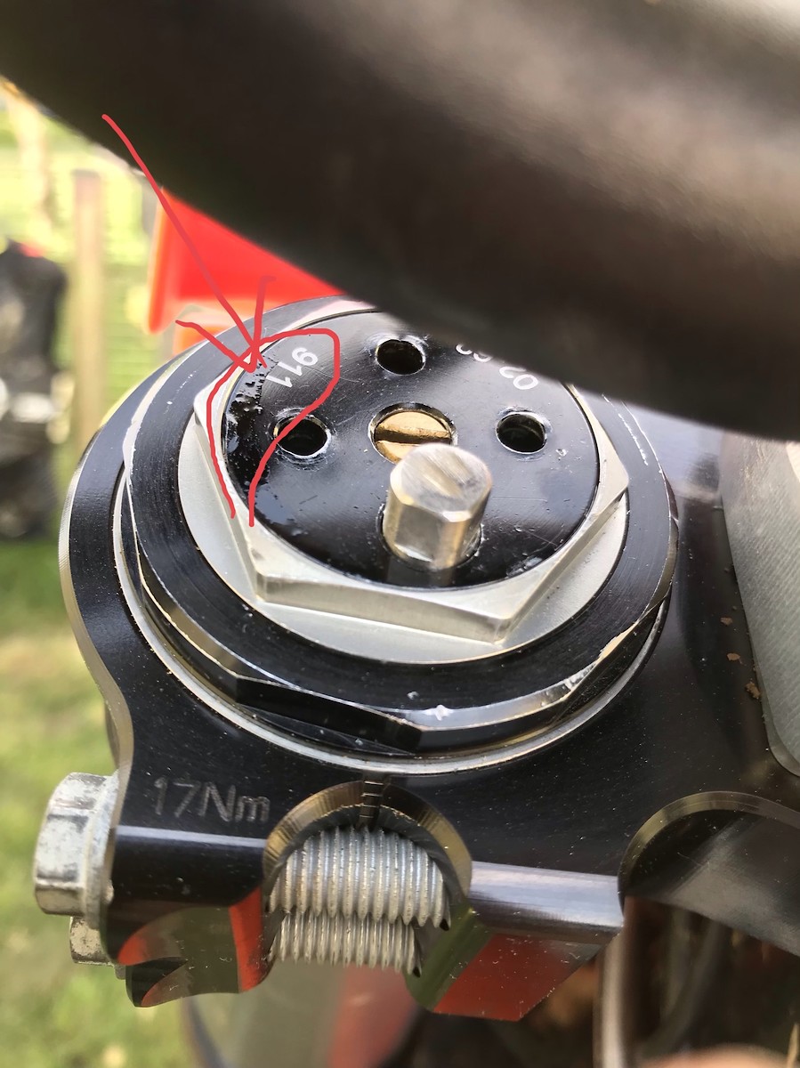

For me it Looks like it comes from the Preload Adjuster
Any idea what can be wrong?

Is there the rubber o ring on the bleed screw?

Mine do the same thing. When I asked Billy at Powerband about it he said it’s pretty normal and if they rebuild that part it still might do it. He had me turn the preload in two turns then out two turns to help set the seal. It worked on one side and helped on the other. It’s just a seep and doesn’t run down the fork or anything.

It's the o-ring where you unscrew the valving stack from the cartridge. Might have pinched it when they put them back in

WP forks with preload adjusters are known to leak at the PL adjuster o-ring as far back as the early 2000s open cartridge forks. That said I'd agree with RockyRider, it looks like the o-ring for the compression adjuster that is leaking.

I call the WP Dealer today he recommend try to
re-tighten the Preload Adjuster Ring on the top .
According to him its a common Problem on CV Forks that this Ring come loose .
I will see tomorrow if its sealed
