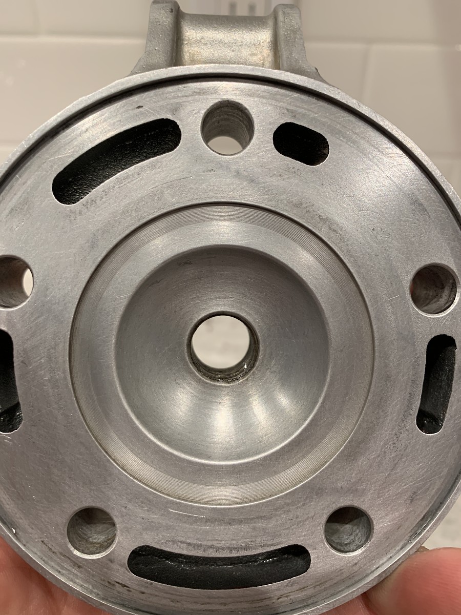

See below pic of my 2016 YZ125 cylinder with about 8 hours on it. Pic was taken at the first rebuild and as you can see the cross hatch is not visible above and below the exhaust port. Yamaha provides extra clearance in this high heat area so that you don’t have clearance issues when everything heats up and expands. My 2014 YZ125 cylinder was the same way and the new OEM cylinder I just bought looked the same way as well. I do not have a pic of the new cylinder.
This was not an overall clearance issue, It was a clearance issue at the exhaust port.

Man, crazy . . . because I literally just got an Athena YZ144 cylinder back today. (My nephew's bike)
Upon looking into the barrel, I notice the bridge over the exhaust port looked like it was relieved. I was guessing
it was to allow for more heat expansion. And I was just about to start a thread wondering same and saw your post.
So this is how it is supposed to look?

FWYT: that is how a "relieved" exhaust port should look. The theory of relieving the exhaust bridge is that the thin material of the exhaust bridge expands more (due to heat) as it has more surface area exposed to the hot exhaust gas and it also has limited material around it to prevent it from expanding into the cylinder bore.
Usually the exhaust bridges are relieved (ground down after plating using a sanding drum) around .001"- .0015" and possibly a little larger on larger displacement engines. Honda used to relieve their exhaust bridges on the HPP 125 engines and the RC valve smokers as well.
If the exhaust bridge in NOT relieved, there is a good chance it will swell into the cylinder and cause a failure like the OP's issue.
