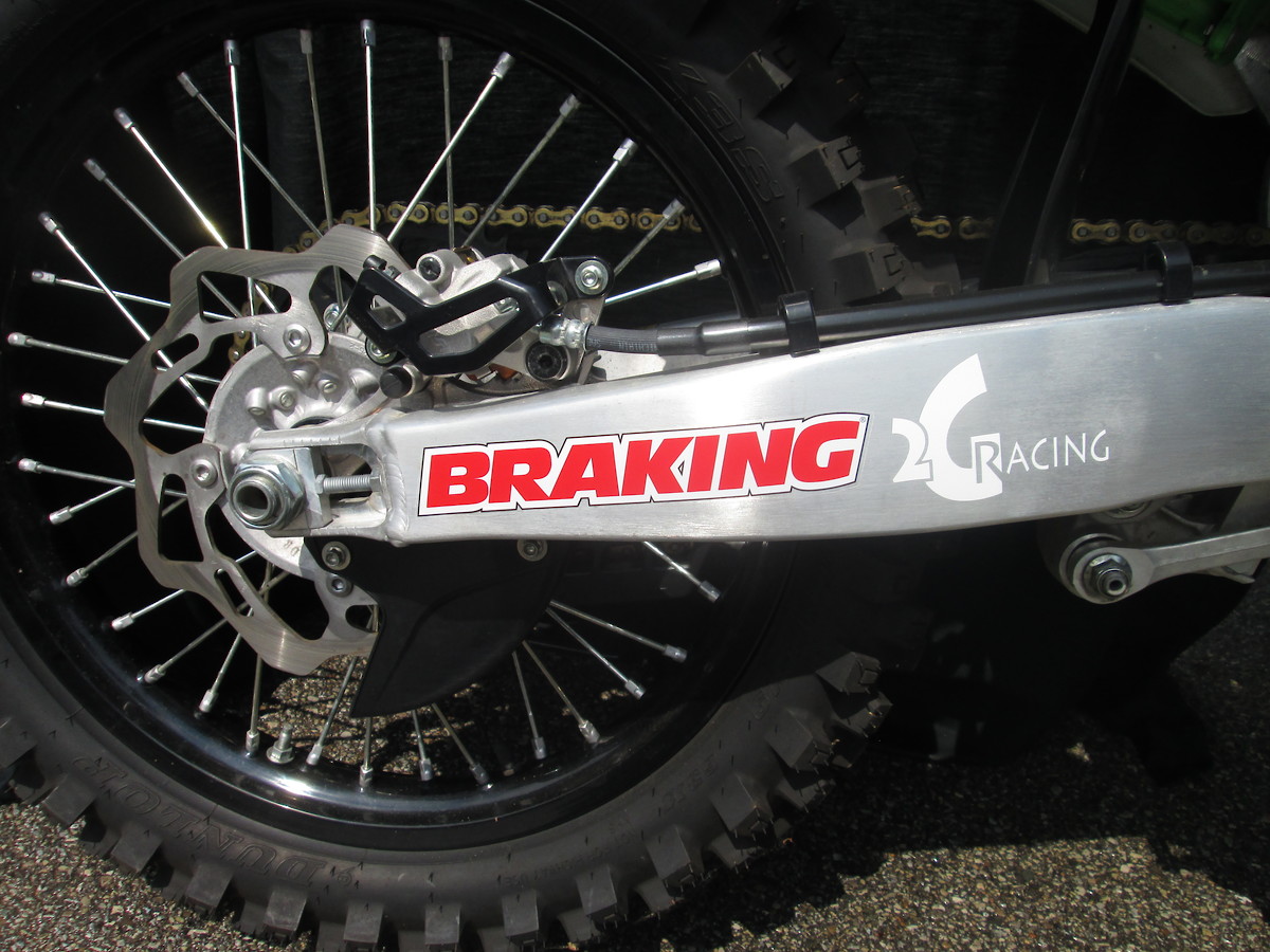

I run Braking Rotors and Pads. Performance is exceptional. Power, but also the feel when under light engagement. The durability is always a bonus. The pads have a longer wear life. I recommend this package to anyone that is ready for a replacement or as a performance upgrade.

Your rotor pattern looks just like those used by the Rockstar Husky guys. Interesting.

What series of braking rotors and pads ?

those look like the WF/KT series. probably with the race pad (CM46). they also have the Batfly series for the fronts and back which look awesome. http://www.braking.com/catalogue/intro.php?lang=EN here is the catalog for their products for a 2019 (not sure what year you have but they are all in there i think) feel free to message me if you need any help. I am pretty familiar with their products.
