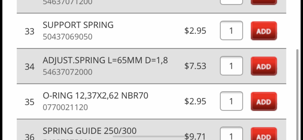

There is also a primary power valve spring out of the 150xcw that helps, the standard sx primary spring is wound with a 2mm wire, and the 150xcw spring is wound with 1.8mm wiring, and this helps get the power valve to start opening sooner, I did this with my 125 sx and it helped roll on and midrange really well
