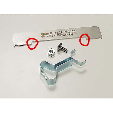

NVA57 Posts 838 Joined 6/10/2015 Location NL Fantasy 1602nd NVA57 10/10/2018 - 6:59am 10/10/2018 - 6:59am Edited Date/Time 10/11/2018 11:51pm Does anyone that have this tool know what the dimensions are? Specially the height between the two red circles. Or if you know another way of measuring the X dimension of a dome piston then advice is very welcome. Save | Quote Log in or register to post comments mx-doctor Posts 27 Joined 6/27/2016 Location AT mx-doctor 10/11/2018 2:36am 10/11/2018 2:36am I have the tool left over from my old 250SX 2-stroke and I measured 3,7mm! Save Quote Log in or register to post comments NVA57 Posts 838 Joined 6/10/2015 Location NL Fantasy 1602nd NVA57 10/11/2018 11:51pm 10/11/2018 11:51pm mx-doctor wrote: I have the tool left over from my old 250SX 2-stroke and I measured 3,7mm! Thank you! Save Quote Log in or register to post comments Start New Topic Share to Facebook Facebook Facebook Share to Twitter Twitter Twitter Post a reply to: KTM Adjustment Gauge Tool for X dimension To post, please join, log in or connect to Vital using your Facebook profile Login with Facebook. Breadcrumb Forum Main Tech Help/Race Shop
