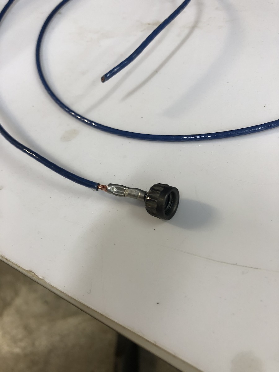

KTM 4 stroke guys tell me what this is used for
2/22/2020 2:20 PM
KC
2/23/2020 11:19 AM
Looks like an inner tube fish to me, but then that would not be just for a KTM.
Paw Paw
2/23/2020 12:22 PM
Well Paw Paw, You get partial credit, I made it to fish the new fuel pump into the fuel tank. What a pain in the ass, and of course the bike had only 11 hours prior to the pump going out. Not going to buy another KTM EVER.
KC
2/23/2020 2:22 PM
I guess that if you work on things you have to invent some tools to help along the way as both you and I have.
