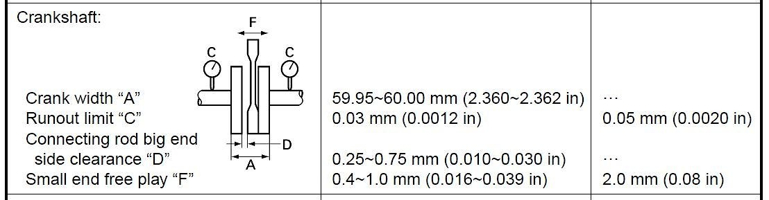

I was able to fit a 0.9mm feeler gauge for the big end "D" measurement.

It looks to me in video 1 like you have much more than that. I can see the big end sliding back & forth on the crankshaft assy.
To reiterate what I saw above, a little side to side is OK. I'd be worried about that much, however.

Go by measurements, not feel but I agree with above. That (visually) looks like a lot of play side to side. My experience with a yz 250 was shattered 3rd & 4th gear (not all that uncommon). While frustrating, it might be a good thing in the long run if you open up the entire motor and take a look.
