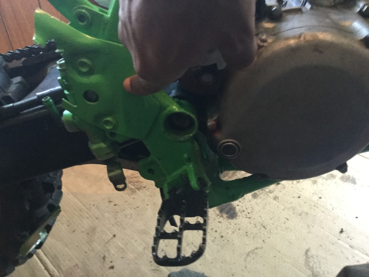

How do I get this cover off? Also how should I go about removing a stripped screw holding the mc to the frame?
Bike is 98 kx125
If the heads are stripped youll have to drill the heads off. That will at least allow you to take it apart. Then the studs you have left will come right out.
If your threads are stripped it depends on how all that goes together. If theres threads in the master cylinder youll need to repair those or get a new cylinder. If theres nuts on the back, take an angle grinder and cut them off and it will come apart.
I looked on partzilla and it’s not a part that is sold individually and I can’t find the entire cap assembly.....anyone know what it’s called or how to find it or the entire assembly, any help is very much appreciated
