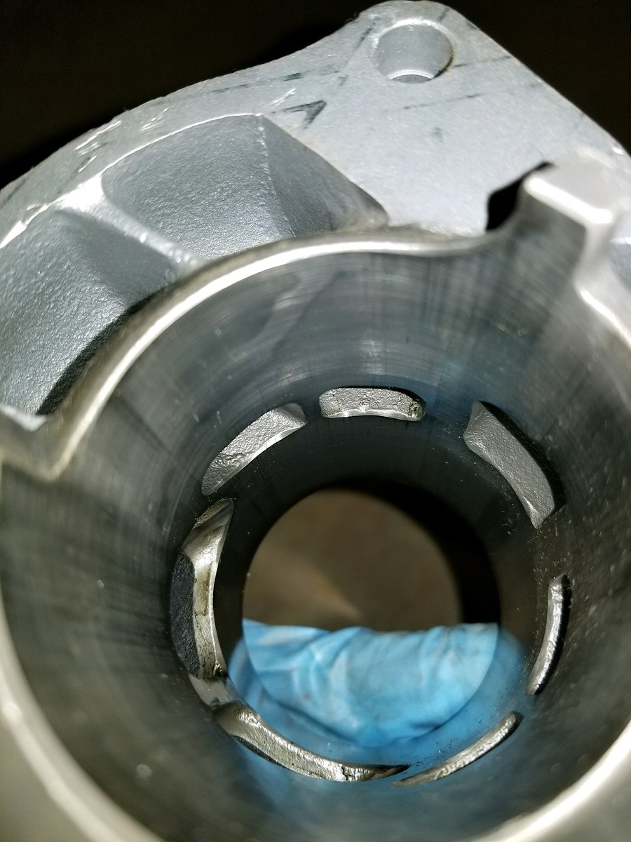

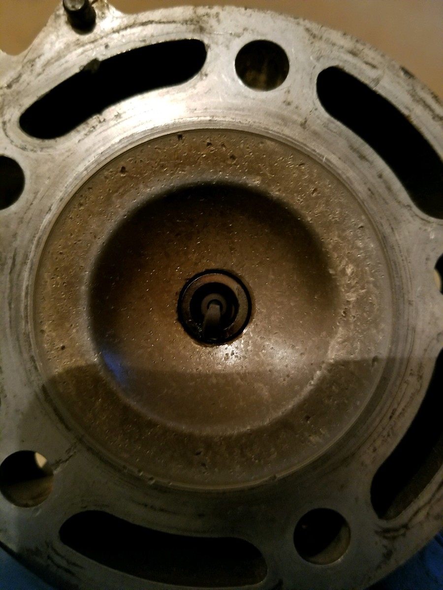

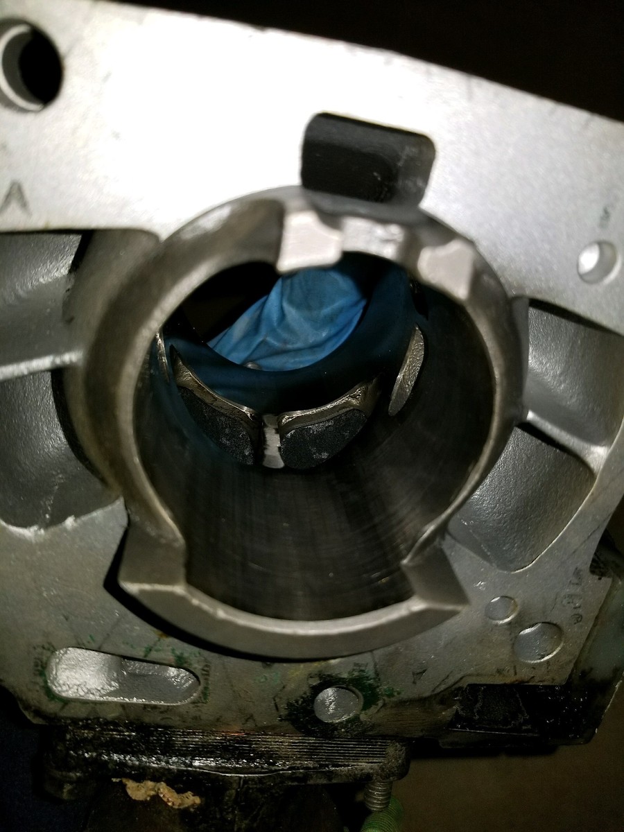

I checked everything with calipers and everything is in spec according to service manual . I just dont have to much experience with this . I have looke dta some other comparisons online when people were told they need a replate . and this one seems as if it has just been plated not to long ago im not sure thats why im asking.
If that was mine, I would deglaze the cylinder with some scotchbrite and WD40 and run it.
I see a cylinder where the proper work has been done in the past, but one that has also been abused by running the piston and rings beyond the normal service life with either a dirty air filter or an air filter that is letting some dirt get through and thus the cylinder markings.
I would suggest that you clean the cylinder up with WD40 and scotch brite pad to see what it looks like then.
Then install a new piston with the exhaust bridge oil holes drilled correctly and the ring end gap set correctly. Do a compression test. and then run it until you see the compression start dropping off and then do another top end.
I would also take a good look at the air cleaner system.
