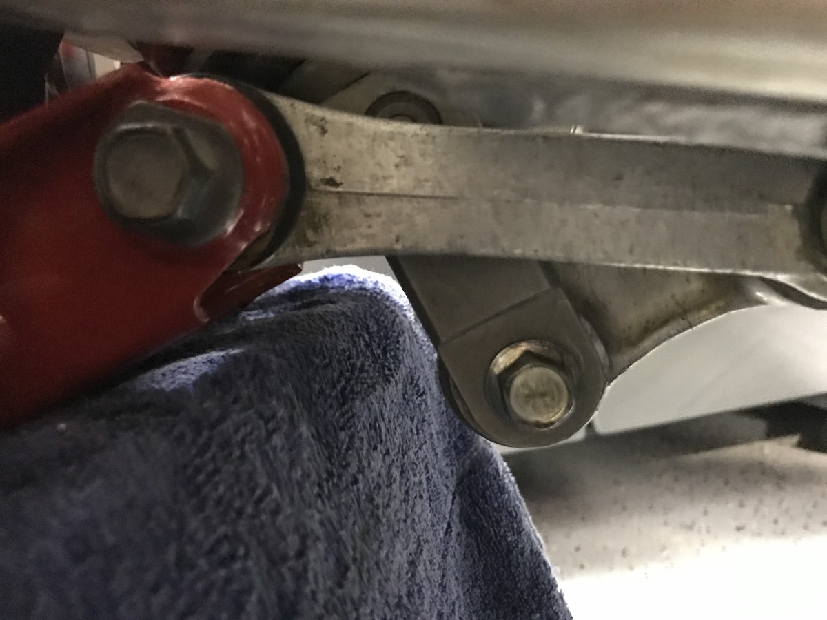

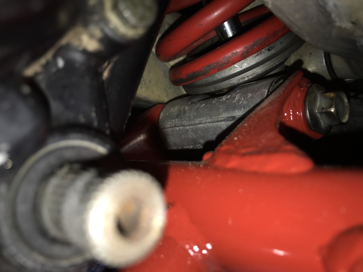

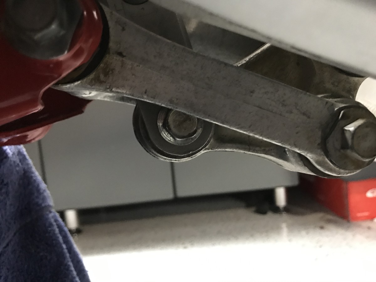

Does anyone have any info on the linkage setup when using a VRP swingarm as the geometry of it is way different than stock. I'm putting a VRP swingarm on a 89 cr250 and it's sitting up higher than stock. Would I need a different linkage setup or is this how it's supposed to sit
Stock:
VRP swingarm:

12/24/2017 12:28 AM
is the arm the same length ??
if it's longer you should need a longer link to lower the bike

The VRP swingarm is half an inch longer than stock. The VRP swingarm was correctly ordered, it just came with minor differences like the chain guide and rear axle but I didn't think the linkage system would change that much over stock. By looking at it, the VRP swingarm uses a different pivot section (the front section of the swingarm) from possibly a 90's cr250.

12/24/2017 9:01 AM
It might need a longer linkage arm based off where it should sit (comparing it with my other 89 cr250 that uses a stock swingarm)
This is where it should sit, About half an inch short.
