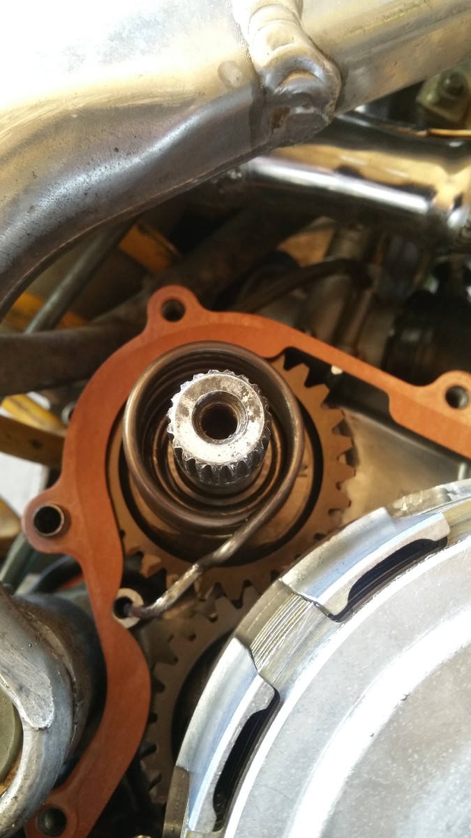

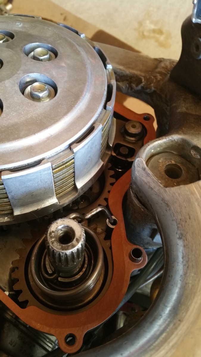

OK I have a friend's 01 cr250r bike that we're having issues with the kickstarter, as u can see in the pics the spring is not staying in the hole. We had an issue with it coming out and jamming in the clutch basket gear while it was on the bench when I was putting it back together.
I took it back apart and compared it to the microfiche and everything appears there. As it sits now the kickstarter was locked up and would not start the bike so I pulled off the cover and that's how it looked. I got this bike in pieces when I rebuilt it so I'm not exactly sure how it went. This was not a problem b4 we rebuilt the bike so what am I missing? Any help is truly appreciated. With the cover off it rotates

The spring is damaged and bent. Get a new spring. Or get a good used complete assemble on Ebay for under $35.

OK sweet. I was hoping someone could tell from the pic what was wrong. Thanks
