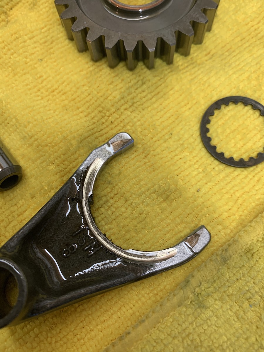

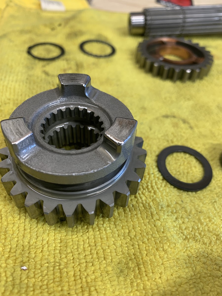

It was definitely the transmission... 2 shift forks and 4 gears(dogs).

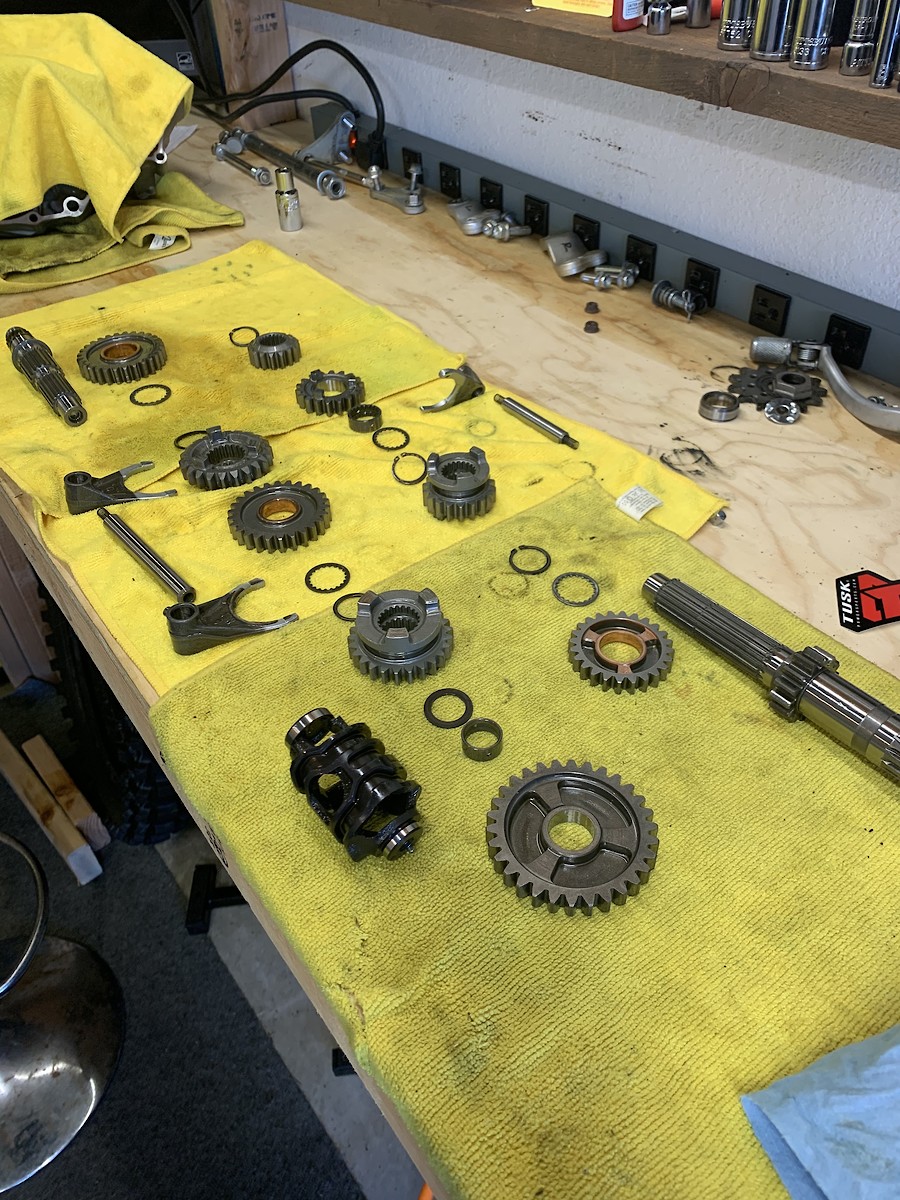

Stripped it down myself (first time ever doing a bottom end) replaced 2 shift forks and 4 gears (bad gear dogs).

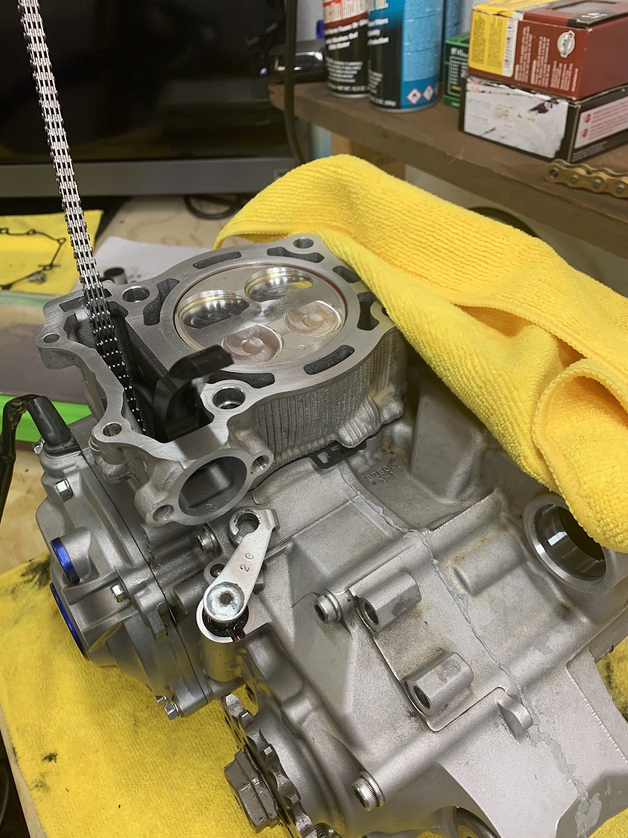

I decided to do a top end while apart as well (piston, rings, cam chain) .... also my first time in a 4 stroke top end.
I just go done today, and it fired right up once back together. I took it for a little putt on the street, and all gears are working properly.
