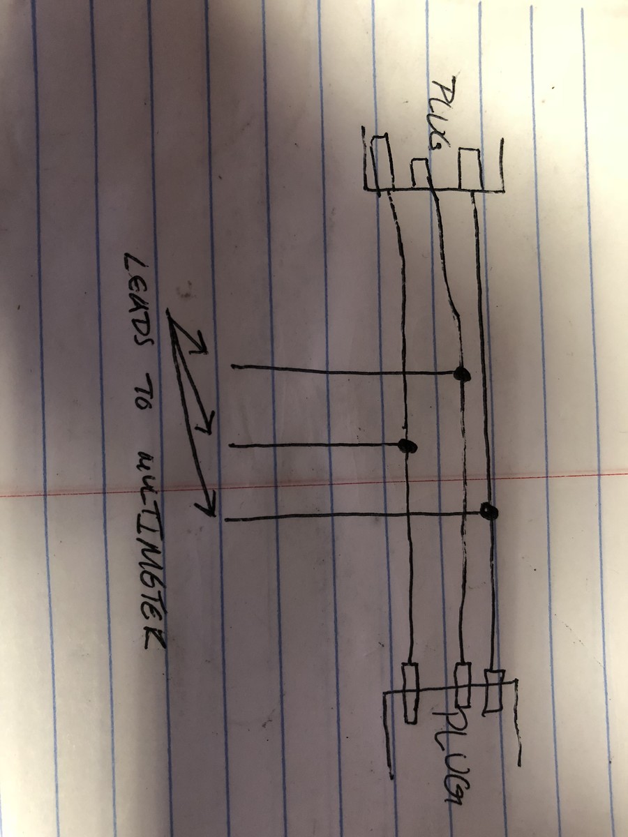

For my bike i made a “T” shaped harness that i could plug in between the harness for the TPS. Kawasaki had detailed schematics on where to put each wire. Then i used my multimeter to read and set the voltage. I would think you can do this on your bike. Might just take some guess and check work to get the voltage reading if Yamaha doesnt have schematics in the service manual.
9/6/2018 6:04 AM
Heres a sketch of what i made.Photo

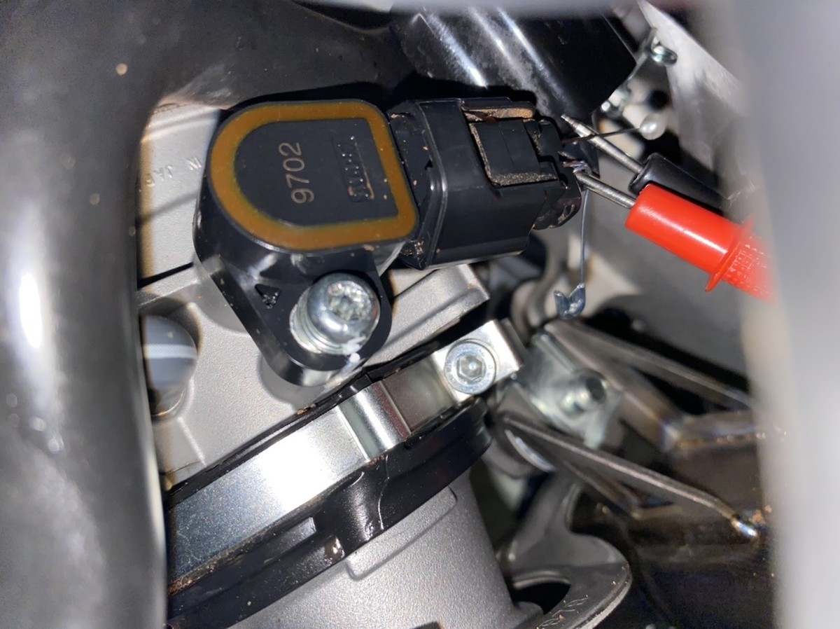

Following the manual, it appears to be in range, but not in the values that you’ve given. The pic shows 5v, and the manual says it should read between 4 and 6 volts. I just need to get a torx bit to adjust it to read slightly higher and hopefully should get rid of the popping in decel.
Fwiw the voltage doesn’t change when I open and close the throttle.

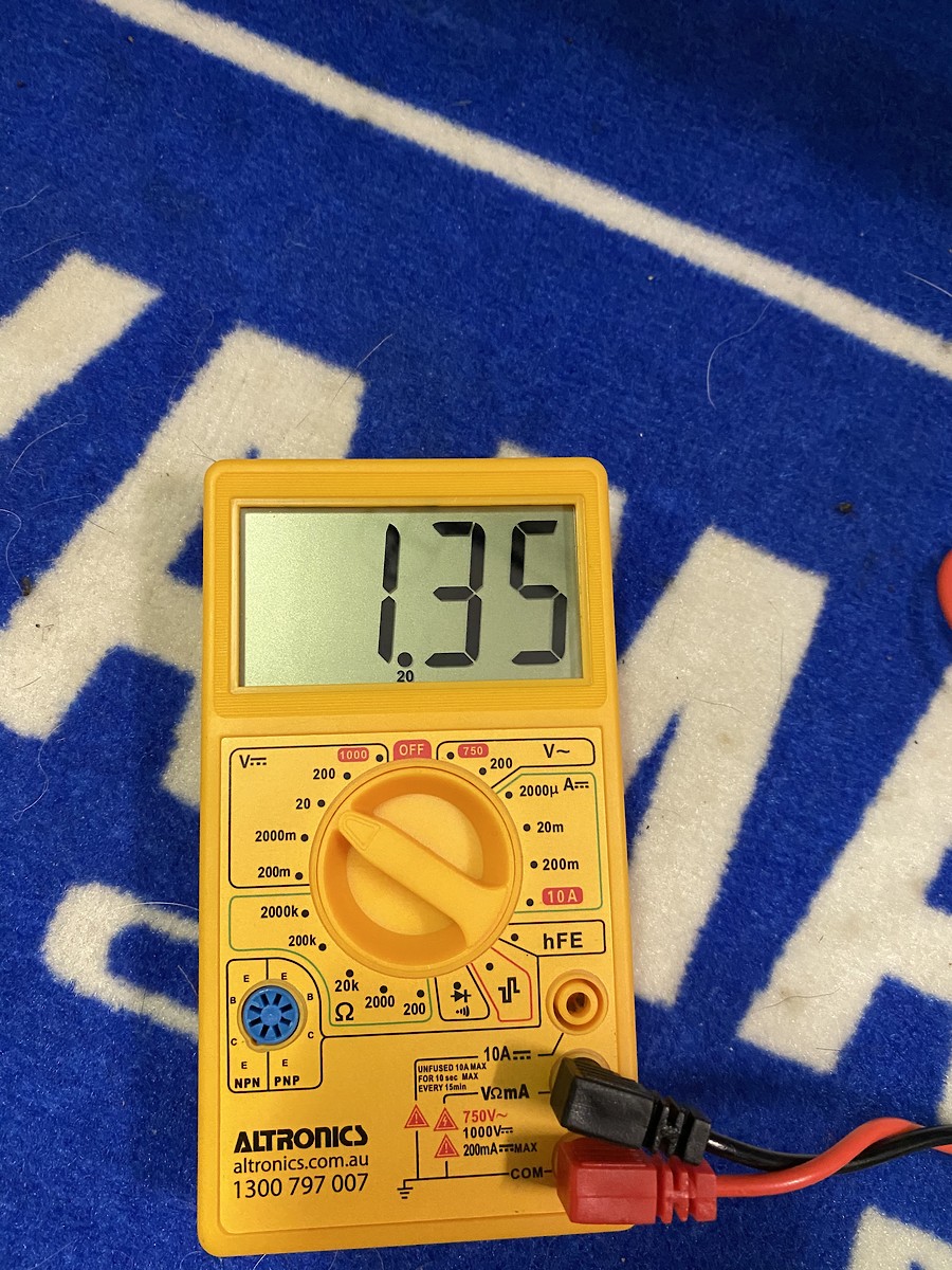

Thanks, turns out that’s just the v5 that the tps uses, I moved the probes to the Yellow and black/blue wire and found these results, throttle at closed position shows this:
And then at wide open throttle:
Looks as though the voltage drops, is this something with the newer models? Would I then what the voltage to drop a bit lower to make it richer?
11/20/2020 4:55 AM
The voltage increases when working and set correctly. That is the industry standard for the TPS operation.
Paw Paw

Ah right. So I still have the meter hooked up to the wrong wires? sad

Alrighty. For anyone else reading this, you slip the probes into the wires at each end of the connector. A probe doesn’t go into the middle wire.
From there you can read the tps input. Mine was .48v, shifted it to .58 then it moved to .60 when tightening.
