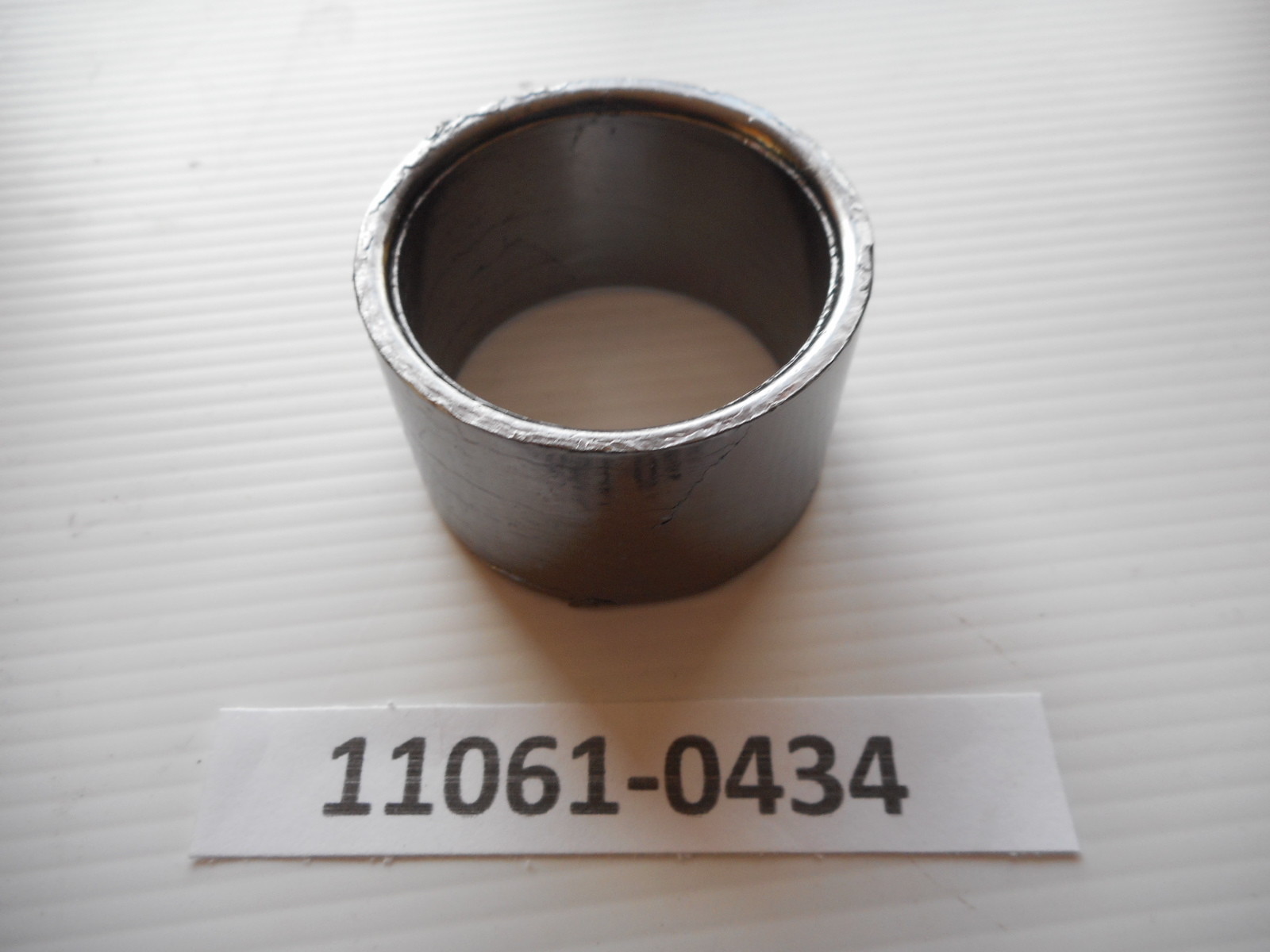

When do I need to replace this connecting muffler gasket?
12/3/2018 3:46 PM
kb228 wrote:
Yes sir thats the one
Titan777 wrote:
Thank you! (:
Idk when it starts leaking i guess. Never had to replace that
