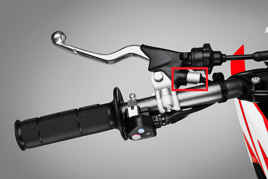

I noticed this on Transworld's intro pics of the bike. What is this second line going into the clutch perch behind the adjuster wheel?

If I had to guess I would say its a sensor? Maybe you have to have the clutch pulled in for the e-start to work?

I believe that's correct. I think I recall someone referencing a clutch safety on the optional e-start kit for the '17 450R. Another "thank a lawyer" piece of stupidity.

easily deleted its just a switch.

Yeah I heard Keefer say that on his pod cast. The 2018 250 and 450 must have the clutch pulled in for E-start to work If the bike is in gear or not.

easy to just take that wire and ground it out somewhere or make a dummy switch hidden so no one can start it

Yea its for the electric start to work, you can I belive take the two wires going in there and put them together, to make it no longer needed and run any lever/perch

yes, did that on my '17 that I put the estart on. male/female connectors down by the diagnostic port, just connect them together.

Just bought mine yesterday and that is exactly right.
