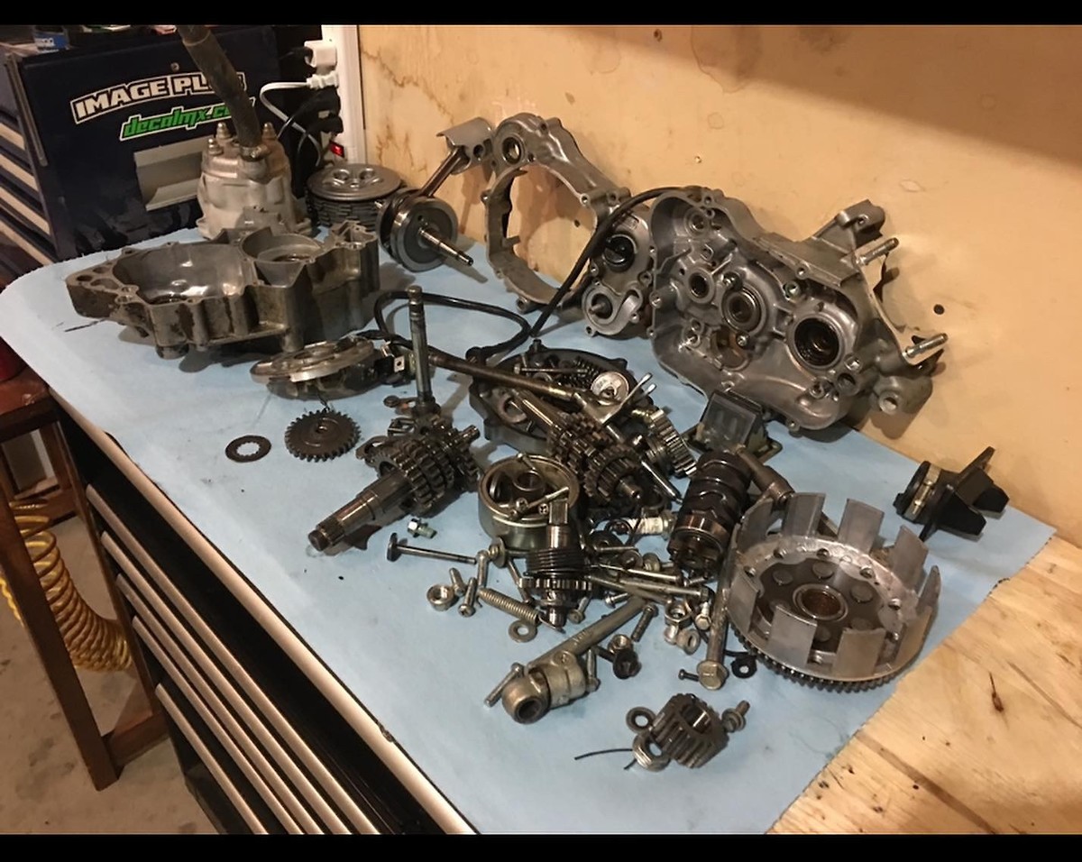

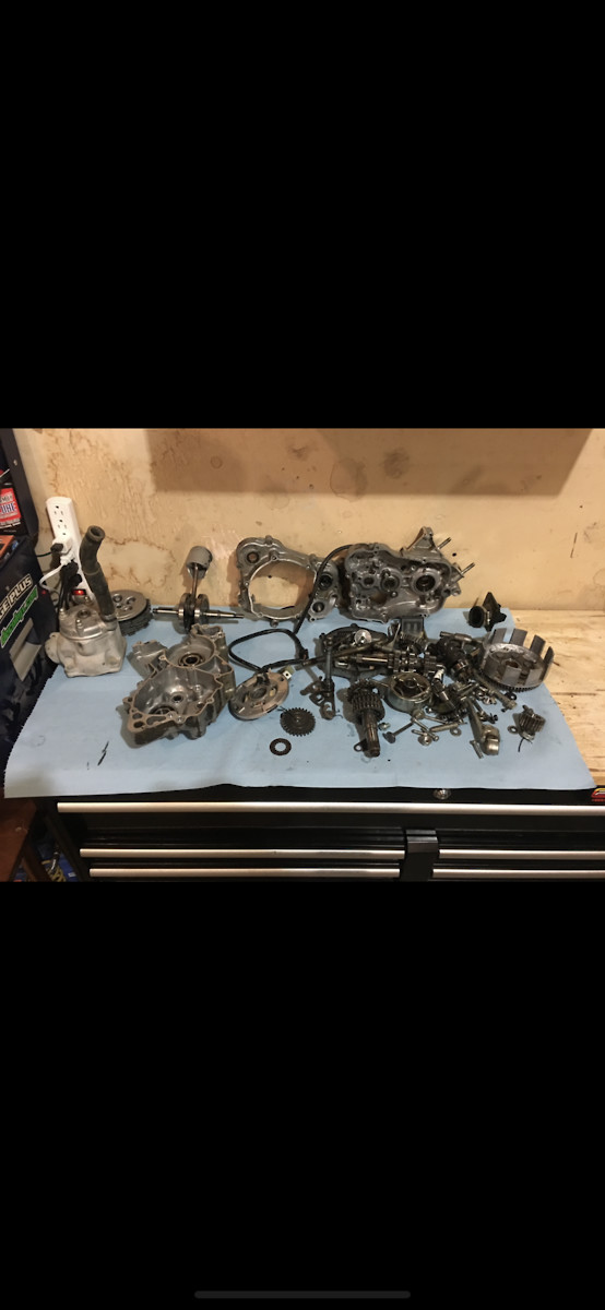

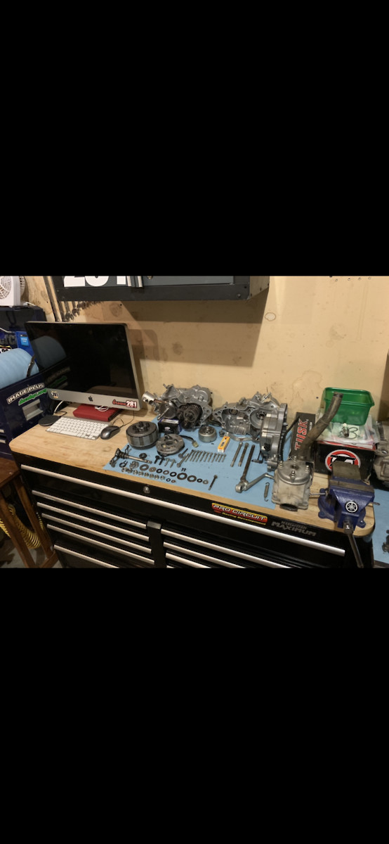

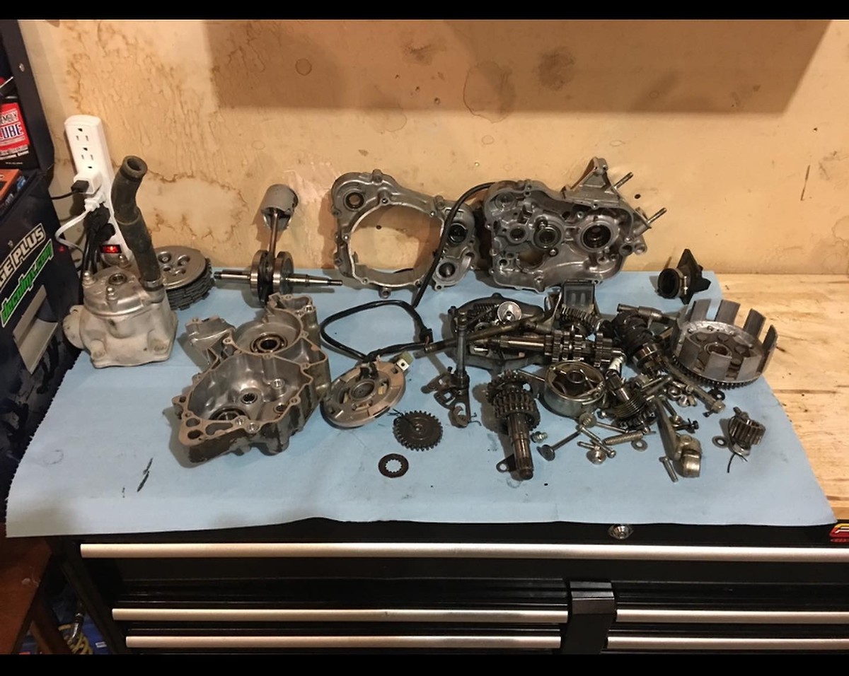

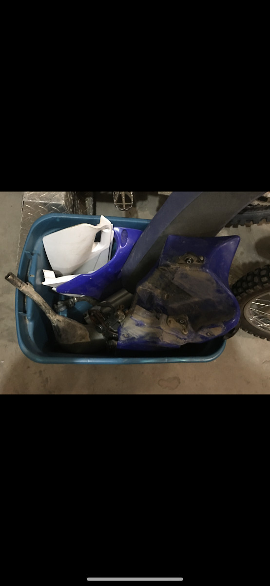

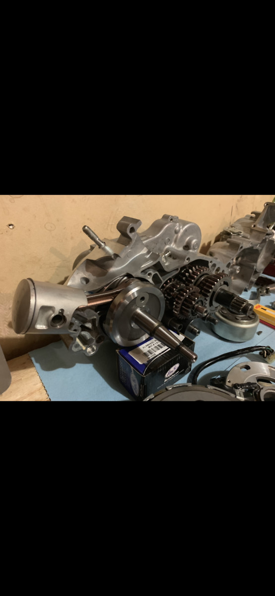

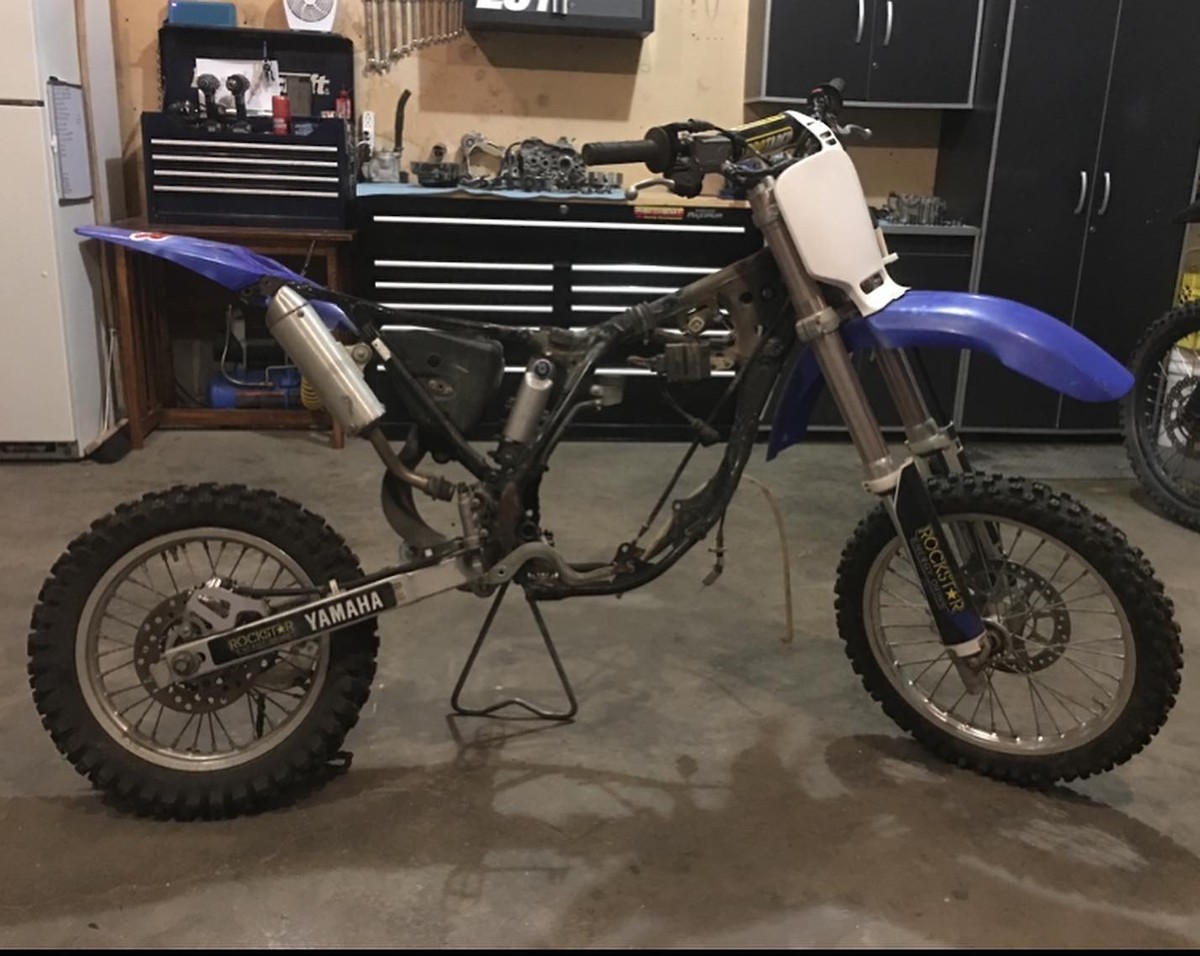

After what seems like probably 25+ Hours of time into this, I finally wave my white flag and have to seek some help. I had someone deliver this minicycle roughly a month or so ago. It showed up in parts and ziplocs, an absolute mess. The father of the boy had split the cases and completely disassembled the bike in the least organized fashion possible. I inspected most every single part and began the rebuild. Old crankshaft bearing was a mess and needed replaced. I just purchased a new OEM Yamaha full crank assembly as well as new bearings, gaskets, top end, and all fluids. I’ve never done a project like this and have spent quite a good time fiddling and repairing my own bikes but figured it would be a good learning tool. I cleaned, inspected and greased everything correctly and followed most strict instruction on putting it together. The transmission was a task but I figured it out (at least I’m sure I did) I replaced the shift shaft assembly due to a small broken edge off the piece. I also noticed the push rod assembly for the clutch was missing. So I had a piece of drill rod machined to spec, but have since put an oem push rod in now. Here is my issue, the bike runs, and runs awesome. Starts first kick, idles, runs clean. But I have zero movement. Everyone I have explained the issue to thinks it’s a clutch issue. I am able to pull the clutch lever in, out the bike into 1st gear, and it will lurch forward much like you would do before say a practise start. But when you release the clutch, nothing happens. No movement. I am lost? It has to be a transmission issue, splitting the cases again just gives me anxiety after all the work I did. But figured before I get there maybe someone can think of something small I may have missed. Photo
