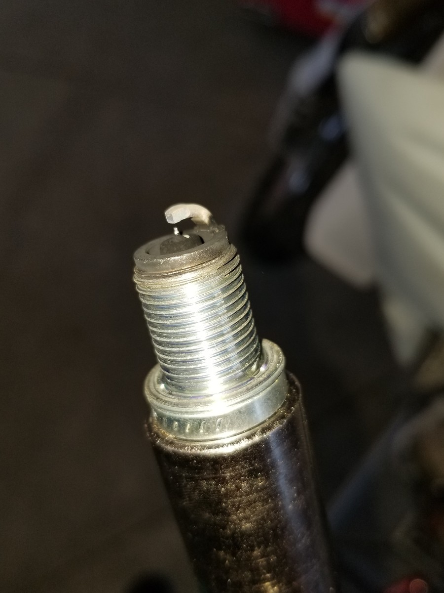

3. I am skeptical of my hot start. When the bike is off, I can hear what I think is the plunger returning to a fully seated spot, almost like a small click if I just pull the lever and dump it and let the spring pull it back in. But if I use this video as a guide to set my jetting and air mixture screw (https://youtu.be/9Ib1SyAHPRs) when I pull the hot start the bike dies. This video would guide me to an even richer jet setting.... But seems like I'm pretty rich already. Here is a photo of my spark plug, pulled after I put in the 48 jet. Black soot, no oil residue.
Next step is pull the hot start and verify it's working well, other than that, any other paths I can look into?

I fix lots of decel backfire on the current four strokes.
Usually it is to lean of pilot jet, although I use an Exhaust Gas Analyzer to find out quickly.
2006 CRF450R my guess after doing many carb rebuilds and rejet is 48 to 50, maybe even 52 to 55 pilot, try the 50 at 3 turns out? The worse the fuel gets the leaner the engines run.
Or, the muffler or mid pipe has a big leak you can feel with your hand.
Lack of mid squirt also causes lean backfire, but you checked it.
If the decel backfire disappears with the choke pulled out 1mm or so then it is just lean. Slightly pull the choke and clip a hemostat on the plunger rod, test ride and is the backfire is gone?
If the pilot jet did not fix it I would check the needle clip and maybe lower the clip, raising the needle and making it richer in the middle.
