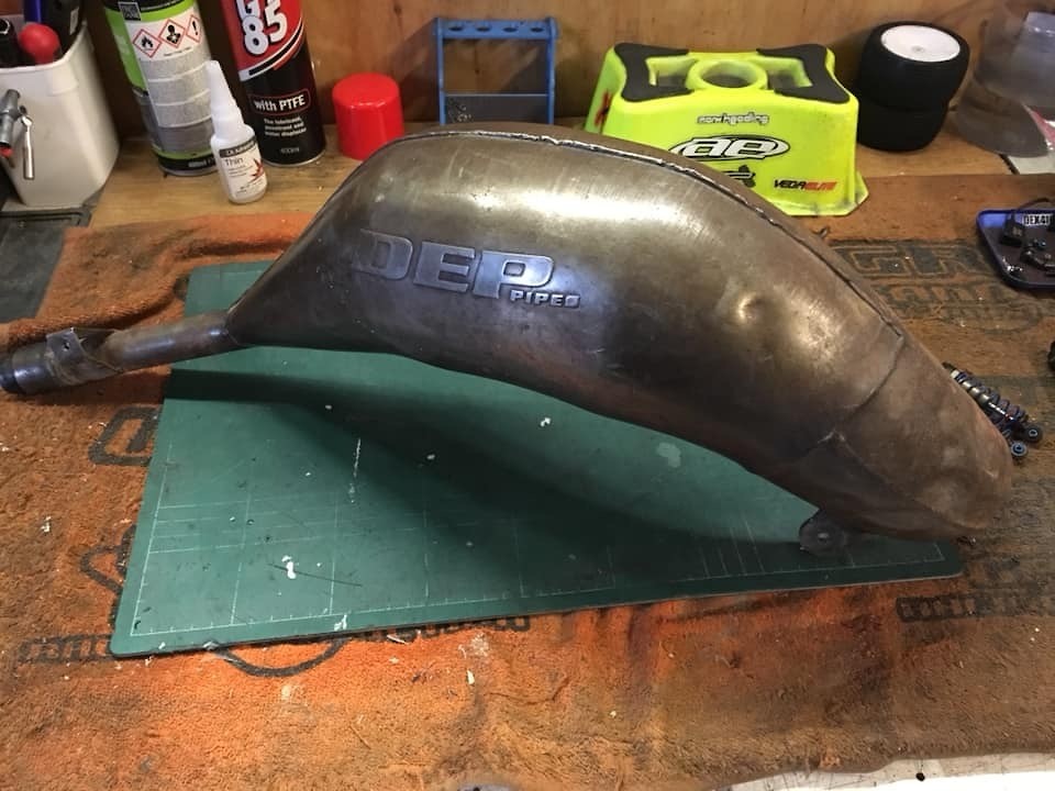

I’ve picked up a used dep pipe for my RM, it’s got a fair amount of surface rust on it
I’ve seen some videos on YouTube using scotch brite/wheels/dremel
Can I cheat and use a vapour blaster or some other sort of soft blasting to clean up the pipe??
Any tips/tricks welcome!

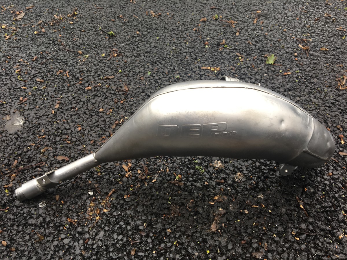

A scotch-brite pad and some WD-40 or other light oil after blasting will have it looking great.

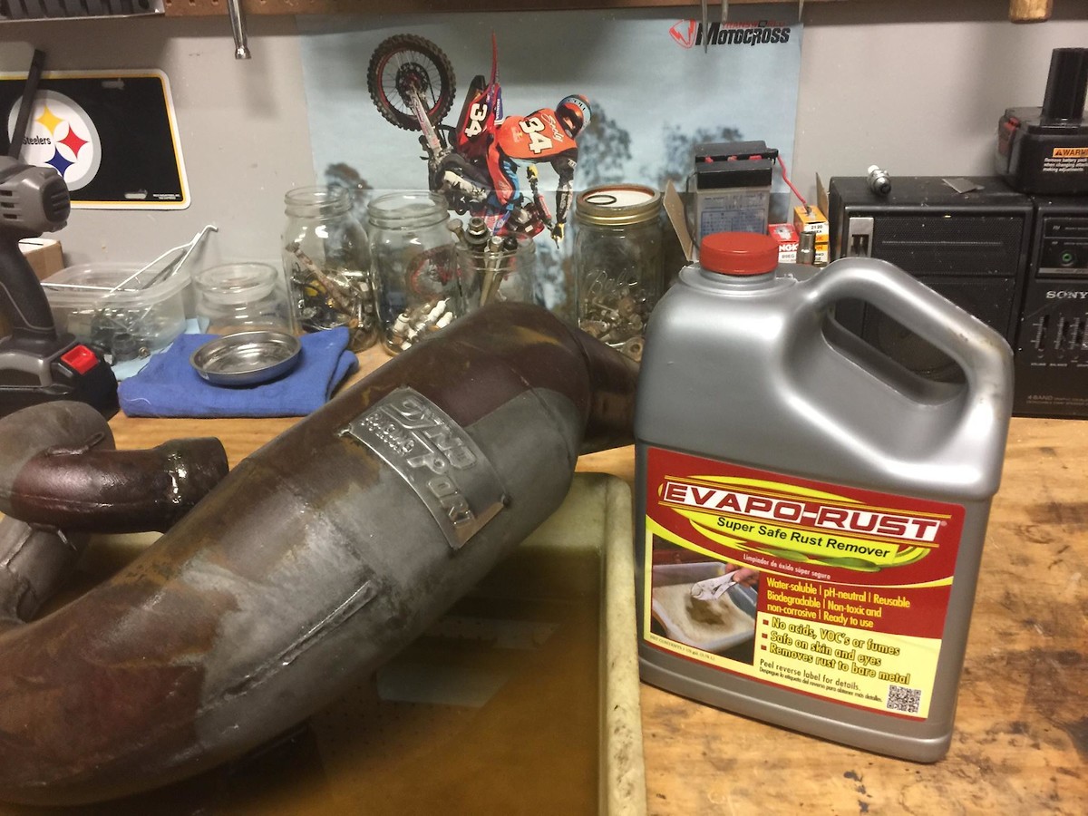

Evapo-rust soaked into a paper-towel or rag and draped over the rusty pipe will remove light rust if you don't want to deal with finding and sending out the pipe. It's relatively low-effort.
It will remove heavy rust, but will take days of immersion in the liquid.

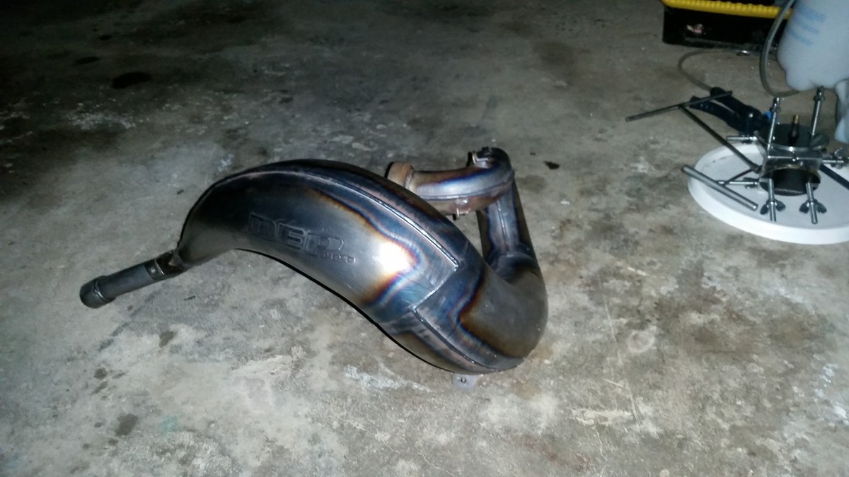

One track i race at waters from a salt water river, this process is a regular for me
Some awesome looking results!!
