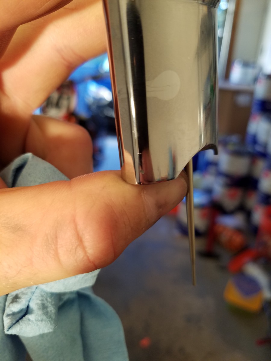

Well it looks like you need a new slide. If it were me I'd buy a new slide and take a piece of fine sandpaper or even a scratch pad and try to clean up the carb where the slide goes making sure there are no burrs in there. Being you have gone through everything else that has to be where the problem is

I didn't like how stiff the pull was on my 17 xc300 either, so I replaced the entire OEM throttle assembly and cable with one from a 14' xc300. The throttle pull is now as light as any 2t that I have owned.
http://www.motosport.com/oem-parts/part-number/51502010200?mmysource=kt… This kit also includes the rubber boot to cover the throttle housing even though it doesn't state that. Mine did anyway. You will also need the correct throttle cable for the 14' assembly as well.
The throttle slide that you have pictured is perfectly fine to be used. That nick won't have a noticeable effect on performance at all.

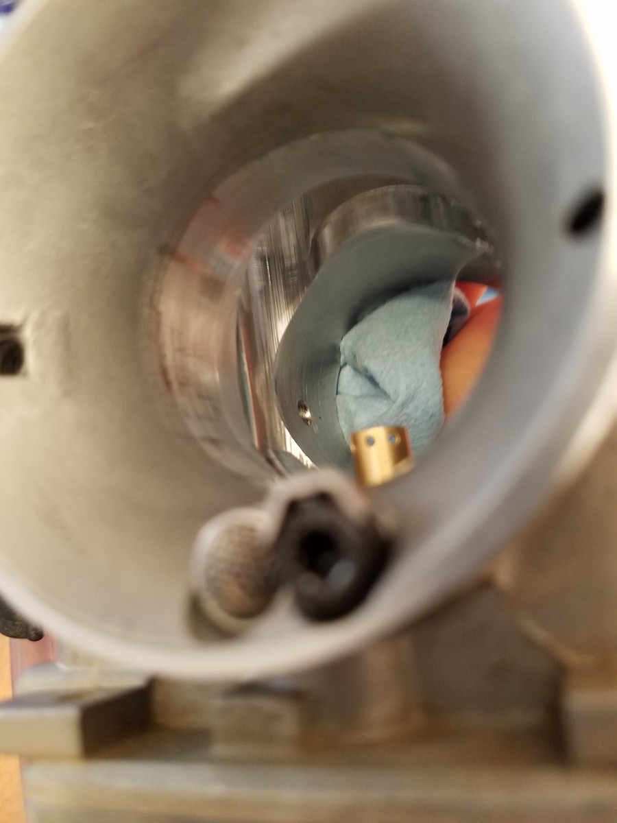

Holy crap James that is alot of gauling on the carb body, looks like something scraped it up. I would use some really fine scotch brite pad and WD40 on the carb body. Hard telling if your chroming has chipped on the slide but if it has on that corner take some scotch brite to that too, to get rid of the sharp snag, and hopefully prevent more from chipping off. See you Wednesday!

ehr400 wrote:
Holy crap James that is alot of gauling on the carb body, looks like something scraped it up. I would use some really fine scotch brite...
Yeah, it's pretty bad. Just bought a new carb, which should be here Fri. As long as I don't get sucked into work I'll be at coops wed!!!
