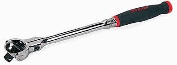

These are my main stays, pretty much all of my gear is Snap-On but thats just my preference (addicted to it).
Snap-On 3/8" drive flex head ratchet, best ratchet ever no argument & 3/8" socket set from 8mm - 22mm.
