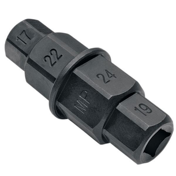

Has anyone Done this mod?
I am looking for the tool they use in the video at 4.30 mins.
Any idea what the hex size is needed to open the cartridge. ...I was thinking I could make something from a coupling nut.
https://youtu.be/DZ27aOQFM9s

I am hearing 21mm, so there is a chance a M14 coupling nut might work.

I'm not sure off the top of my head, but I think it's a 19mm. I use my Motion Pro axle tool when I take them apart and it works like a champ.

slipdog wrote:
I'm not sure off the top of my head, but I think it's a 19mm. I use my Motion Pro axle tool when I take them...
Brian, i take it you are comfortable pushing the piston/ damper rod through the cartridge seal, rather than using a bullet in the video???

Brian, have done any of these tac glide kits?? I've done the cart seals on the old twin spring showas and I used a 17mm

Some one in the air fork thread said it's the same tool(22mm) as Kawasaki-Rider linked above. Guess I was wrong and need to pay more attention, lol

LOL, so now ive heard 19mm, 21mm and 22mm hahsahash

guess i am gonna have to take them apart and measure Smile

9/16 nut, I bored it out to 15mm and it looKS like it will work

This is the tool I used to drill out the nut....it's a cool little tool that I use to take the peeens of showa shock shafts without taking too much metal away
