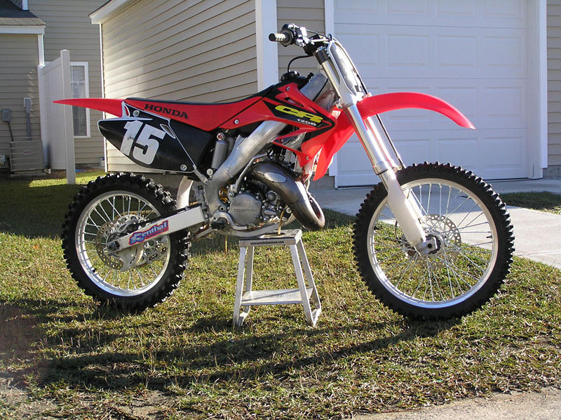

I have an interesting scenario with an 03 Honda cr 125 I picked up. I have rebuilt the entire motor (OEM crank etc), I have a 134cc cylinder with existing port work and a brand new cylinder head from Honda.
Could I send you the cylinder and cylinder head and have you determine what needs to be done? By that, I mean cut the head to fit the 134cc properly and at least look at the cylinder to try and determine if the existing port work is ok or junk? Thank you.
The head modifications will be $75. The cylinder may be simple to evaluate but if it requires more detailed measurements we would charge $35 or so.
Thanks!

seth505 wrote:
I have an interesting scenario with an 03 Honda cr 125 I picked up. I have rebuilt the entire motor (OEM crank etc), I have a...
The head modifications will be $75. The cylinder may be simple to evaluate but if it requires more detailed measurements we would charge $35 or so...
Thanks!
Sweet, thank you for the info. I'll be contacting you to send it in.
