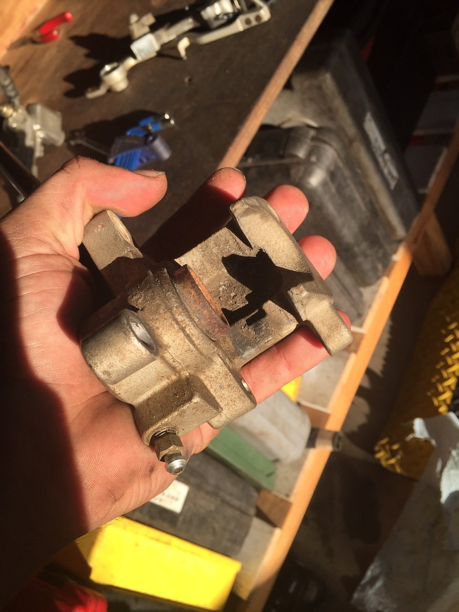

I cleaned up a few more parts in my little blasting cabinet before I left for work. It takes a while coz my compressor isn't big enough to run the thing at full steam.
Stripped down the front wheel. Took me ages, tried to save the spokes but then I realised they are way to hashed to use again so I'll buy some staino spokes for the front, the rear already has stainless spokes (maximum win!). I'd like to get the anodising stripped off the rims and get them polished so that I can get them custom hard anodised but I also have half a mind to just lash out and buy a pair of "old school" gold excels (everyone's got black rims now)

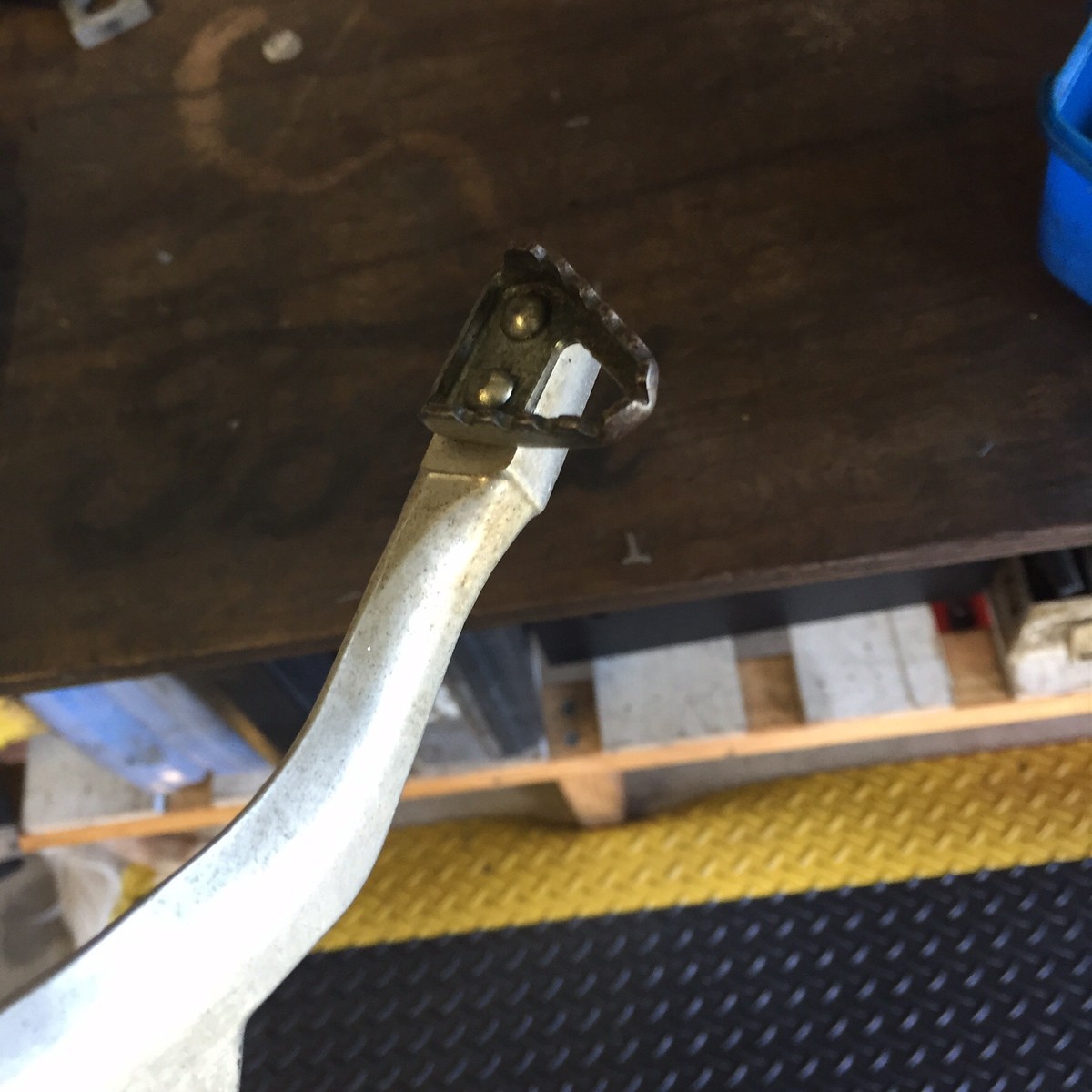

3/21/2015 4:23am
I'm told that if you remove the oem pressed steel brake tip from the lever & tap out the holes that a Hammerhead oversize brake tip will bolt straight up. Seems like a great lil mod I'm keen to try, so I ordered one and ground down the heads and punched out the rivets and ran a tap through the holes, also ordered a Hammerhead Pro Brake return spring king as well, they only list them as fitting the RMZ's but I have faith that it will fit.
