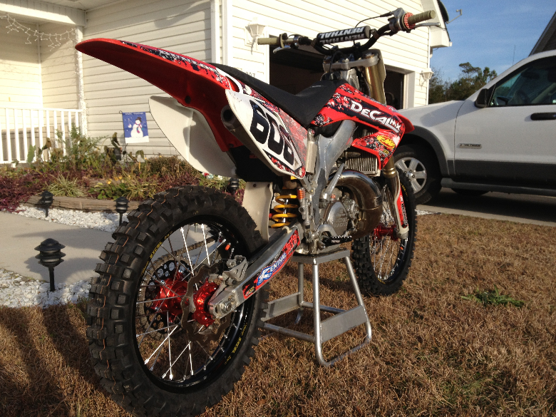

Great looking bike man! Hopefully mine can come out just as well as yours did...fine work!
