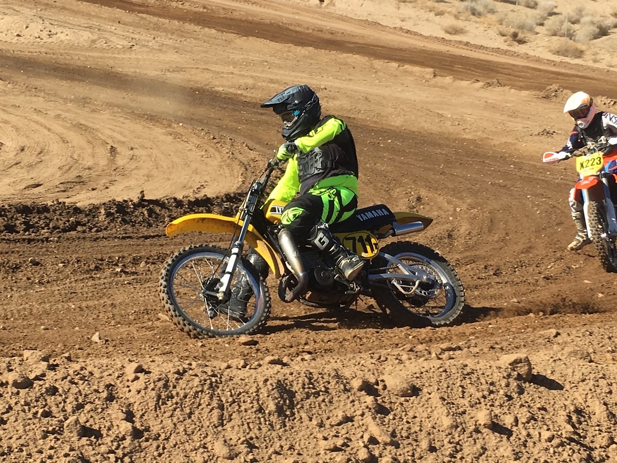

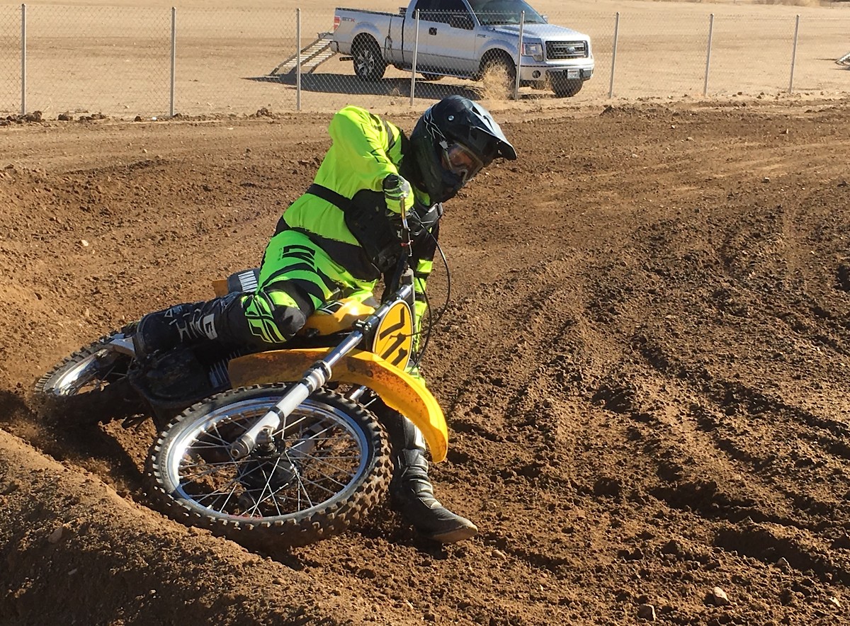

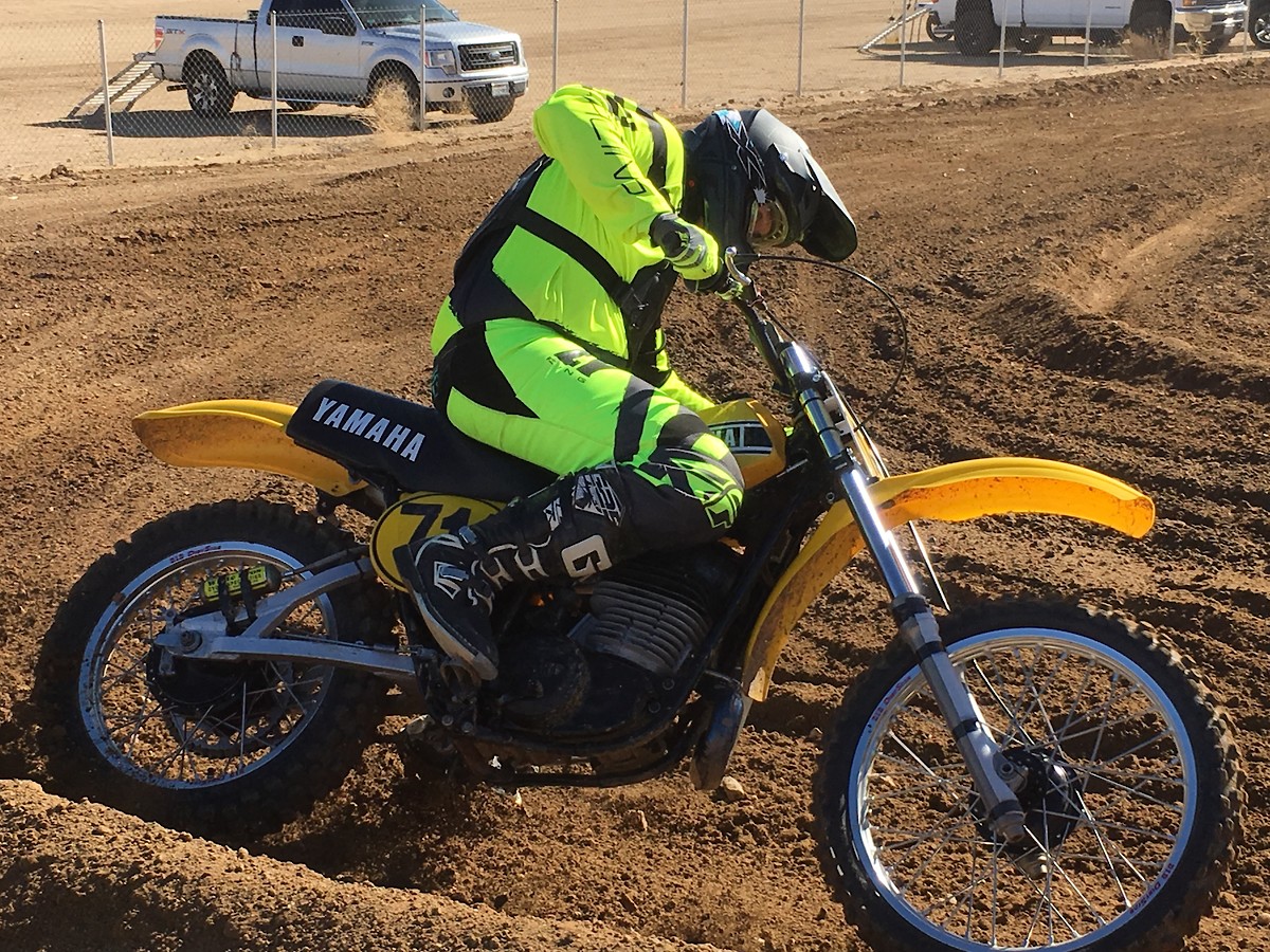

Finally got the chance to break in/ride my YZ400E this last weekend, and I'm still smiling!! I was generally worried I might not enjoy this old machine much considering I've always ridden modern bikes. To my surprise, I couldn't get enough. Usually I get a bit bored with the vet tracks but it was just right for this vintage machine. For a ground up build, with many guesses on set up, and not knowing what to expect, the day went flawless. The only thing that vibrated loose and fell off in an hours worth of riding was the rear fender! LOL The one area of performance that was a big disappointment was the brakes- not so much bad, as down right dangerous. I thought I would hit up the vital old school brain trust and get some input on things to look for to maybe improve the brakes. I've read all the drum brake related posts on vital before even putting my bike together, so I was feeling confident I would have a good handle on setting these things up. But maybe I'm missing something, or maybe I just need to come to terms with vintage brakes. Here's what I've got:
Front: Proform relined brake shoes, new Terrycable front cable, and new MSR quick adjust modern clutch lever ran upside down. Drum has been trued and shoes have been arced. Brake arm set up so it starts with an acute angle and gets as close to 90 degrees as possible when applied. I wouldn't call the front dangerous, but I was expecting a lot more. I can pull the lever to the bar at 20 mph and while it stops adequate, there is not chance of it locking. and it's a little tough to break with all 4 fingers on the track. I'm worried maybe my front cable is an issue, or maybe the lever lever ratio is off, as I can adjust the lever to the point where one more click and the wheel will drag, yet I can still pull the lever to the bar. Is this normal? any one have any input? Or is this par for the course- welcome to evo-mx?
Rear: The rear is actually worse- same setup as the front, but even less power. The YZ has a pretty short throw on the lever as it is captured between the clutch cover and the lower frame rail, which I think isn't helping. I have the brake adjusted is it is just starting to drag, yet I can press the lever all the way down to the frame. It won't lock the rear wheel at anything over 10mph, and it is almost ineffective at speed. I haven't pulled it apart to check shoes contact yet, but will this weekend. I'm guessing it should be way better than this. Maybe the need more break in? Maybe I didn't bed them correctly? Any input or things to look for?
Heres some pics and a vid: :-)
