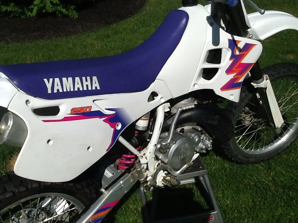

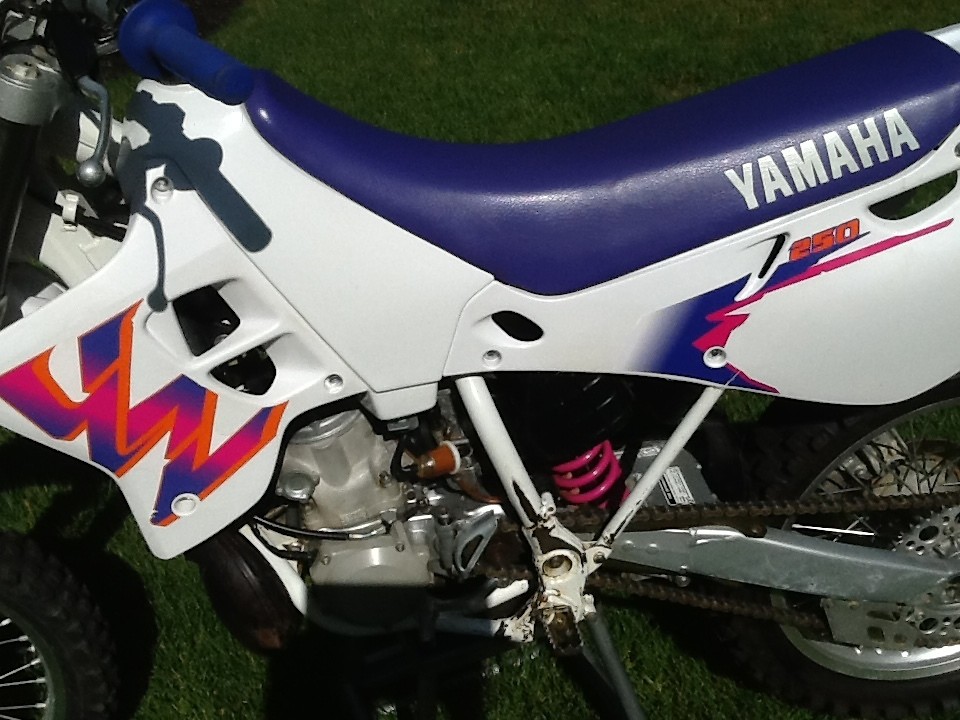

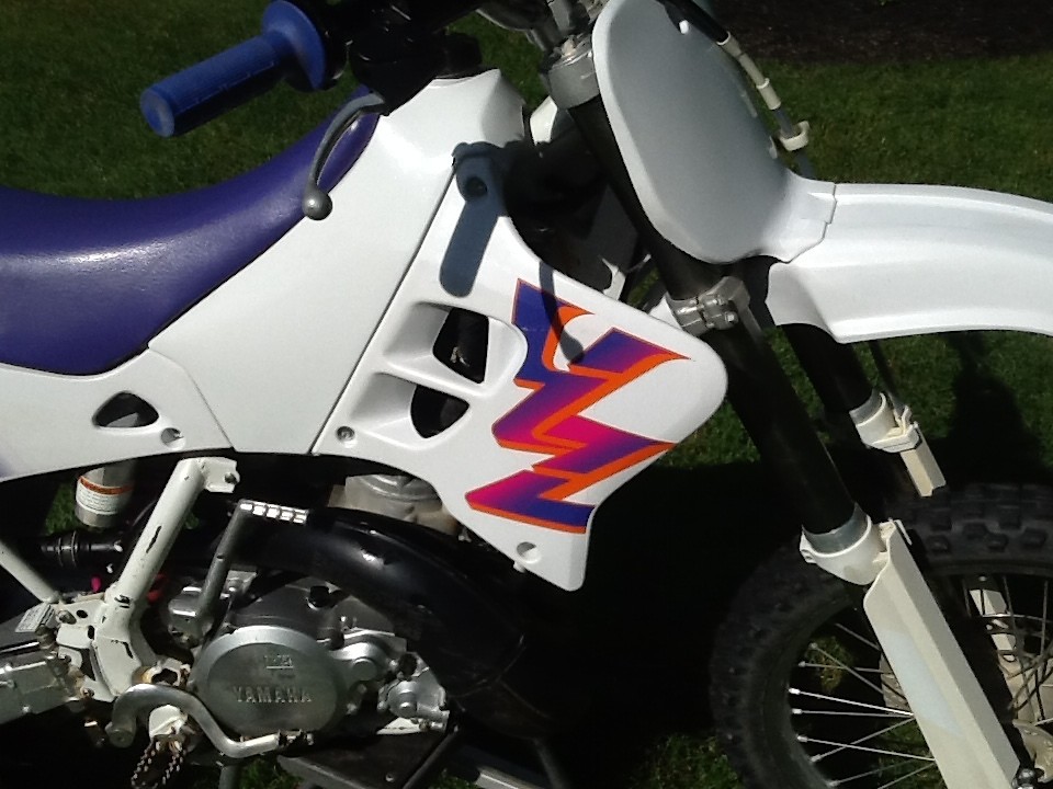

The '88-'92 design is by far my favorite YZ250. I have an '88 that's pretty decent, just haven't had the time to go through it. I'd love to make it look like it just rolled off the showroom.

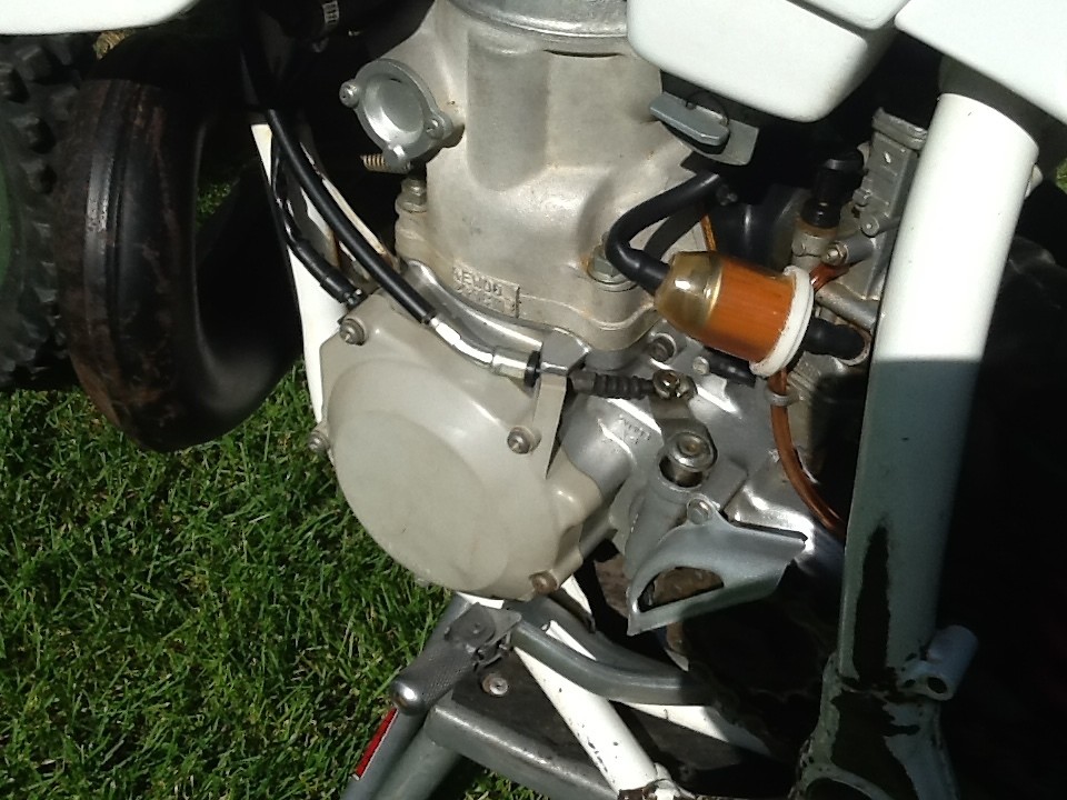

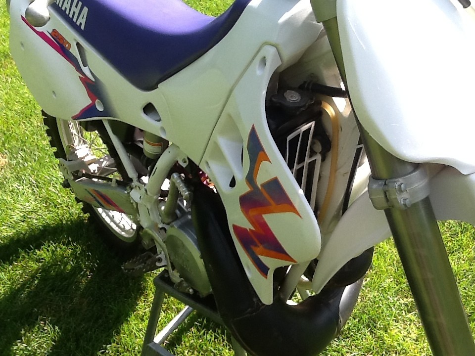

Rescued just in time, stock air filter starting to rot away.
Standard carb clean. Check jetting. Needle clip was dropped, making bike run too rich, explains the excessive spooge.

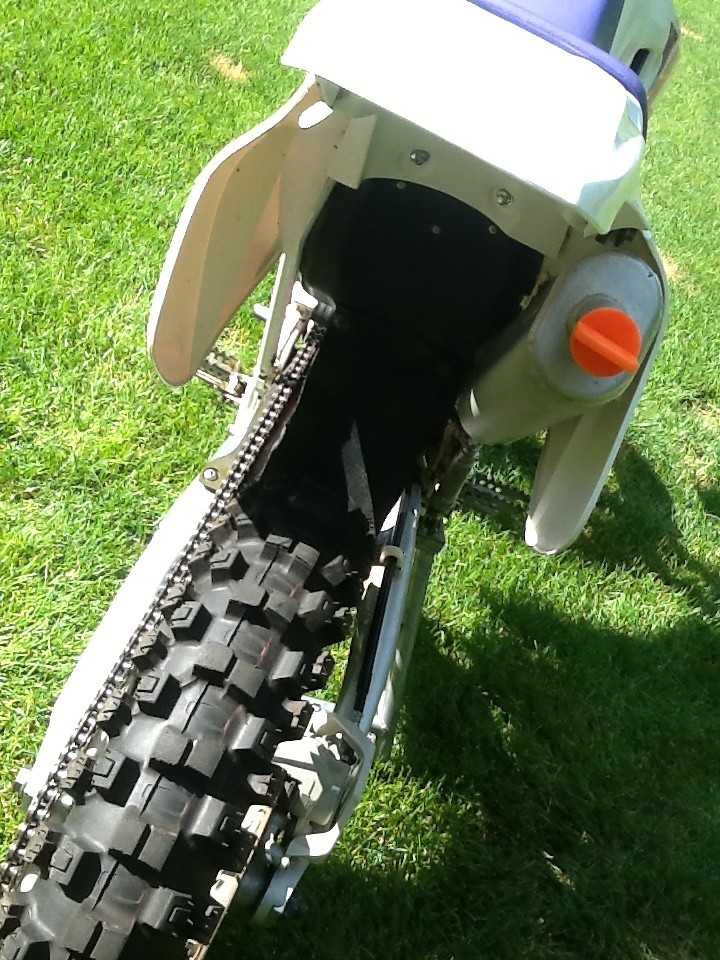

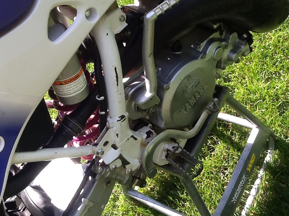

Rear wheel bearings rusted/ loose, likely never greased, lucky the axle came out... Hopefully the linkage was greased at some point but not expecting it....good news is the piston looks original & pretty good, no scores on cylinder, reeds look good. Going to leave the top end alone for now. Needed both exhaust brcts. Douched airbox out.
