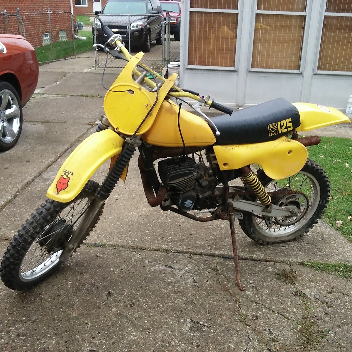

Got this for $200 today. I usually like the metal tank RM's, but this thing just looked too good, except for those crazy fenders! lol

That looks like a very low hr 79....fenders are original, ugly..yes, but they grow on you.. For a 79 to still have the original fenders, rear chain guide, spring loaded front chain guide ,rear shocks, upper chain roller wheel on swingarm, kick stand & what looks to be an original rear sprocket..plastic, silencer , seat cover,.maybe tires too! Very nice score

Even though it has been forgotten about you found yourself a great bike to start off of. By the kick stand and strait floating brake arm I know that was never a racer. All race guys back in the day used milk crates for stands. And the brake arm got bent when you tossed the bike up on the crate.
I had a new 79. I'd like one again . Good Luck with it. You're in for good times

Isn't the "T" a 1980? I think the 79 is a "N".

Honestly, I'm still a little confused about this. My frame nbr is RM125 107914, Engine nbr RM125 108261.
On two different Suzuki identification charts I've seen, that makes it a "T" model. So does that automatically make it a 1980? Or did it come out midway through 79' or something similar that could mean it could be either? When looking at parts diagrams, I'm able to pull up both the 1979 or 1980 models and see the multiple designators; with "T" being used for both years.

Other than the goofy fenders on the 1979 RM's being east to spot, I seem to recall the 1979 RM125 "N" models had a brake rod for the rear and the 1980 "T" models used a rear brake cable.

The 79 is n model & 80 is t model, best of my knowledge no mid year release like in 78. Easy to separate the 2, 80 had better, beefier rear chain guide, no spring loaded front chain guide & used a swingarm buffer on top of arm vs the 79"s roller wheel. I also think the 80 engine used a heavier flywheel, and maybe some mild porting differences, believe the 79 engine had slightly more "hit" to it..... And When I say "hit" take that with a grain of salt....both are excellent choices for restores or racers due to the availibility of parts still floating around, I had a 79 125 back in 82-83, bought a dg head for like 10.00 brand new! Of course it did nothing for performance, but was cool as hell!
11/15/2017 6:55 AM
The 1980 frame numbers start at RM125-102503. The 79 frames start at Rm125-84328. The engine numbers are strange as the Suzuki ID book shows the 1979 engine# starting at RM125-84645 and the 1980 starting at RM125-83087 which seams backwards?

Welp, I definitely have a T model (beefier chain guide, swingarm buffer, rear br. cable etc.), so I guess it's an 80' after all! Previous owner listed it as a 79 and the parts houses show parts for both N and T during both years, but that was all misleading. Thanks guys for helping clear things up. It would have become apparent once I started tearing into the resto process, but I haven't had time to touch it yet.
