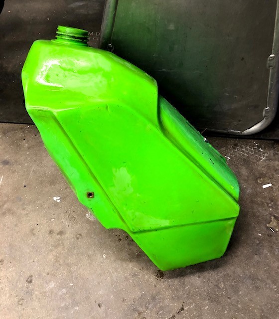

Picked up a mid 80's KDX fuel tank to restore. I've successfully brought back red, yellow and white plastic fuel tanks but this one has me stumped. The green plastic is very dark and has spots of black on it. Underneath you can see the correct color. Sanding with 320 wet/dry paper for 15 minutes did almost nothing. Scraping with a razor blade yields a slight improvement but not the kind I have seen with other colors of plastics. The white areas are where I was sanding.
Is this thing beyond hope or is there a trick to bring this tank back?

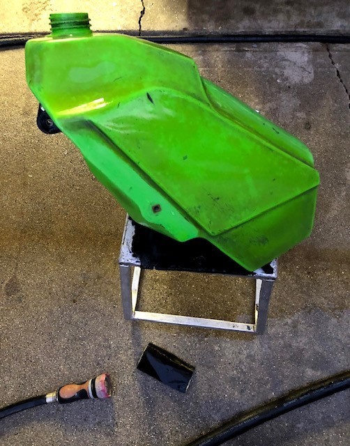

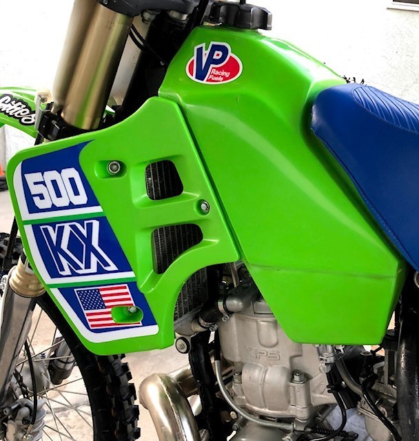

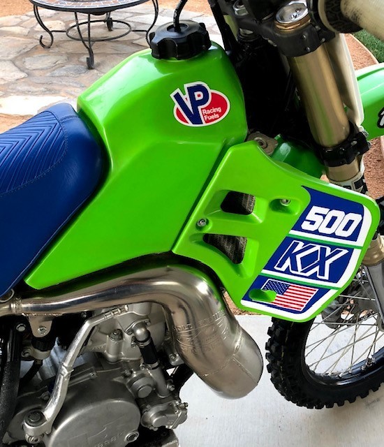

Yes it can be done! Prior to the roached '89 KX250 tank in the first image below, I had only done some yellow '74 Yamaha MX100 fenders and those were really simple in comparison! This '89 KX250 tank was a different story and took a lot more elbow grease to remove several coats of bbq black and lots of oxidation and scratches! Just keep at it with the razor bade, I prefer to use it at a 90 degree angle to keep from adding any new gouges. Your tank seems to have some existing deep scratches in it, so be careful trying to chase those too far as the plastic will start to become translucent if you take away too much material. My tank had a deep scratch on one side and I decided it was too deep to try and remove. Once you get the discolored areas cleaned up with the razor blade, you may want to start a little heavier than 320, like a 220 wet/dry to remove the razor blade marks. After that, then move back up to 320 through 2000+. I can't seem to find the website anymore, maybe it was on eBay, but there was someone selling buffing pads specifically for plastic. It worked great for me, just gotta be careful to keep moving around the tank so it doesn't get too hot and melt! Overall, I'm happy with the end result, it isn't show quality by any means, but this is a race bike, so I'm good with some character! Keep some cold beers handy and good luck!

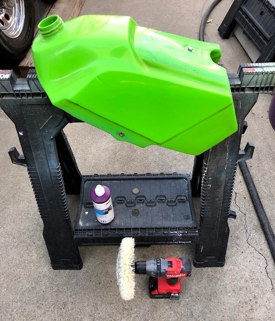

Here is what I used ... foam buffing pad, any fine cutting compoundPhoto

The final shine is easy. I used a regular buffing wheel. The kind that goes in a bench grinder. I got something from Lowes so I could fit in into my cordless drill. Use low speed. Fast will burn or melt the plastic. Couldn't hurt to use the final polish spray from the Novus 123.
