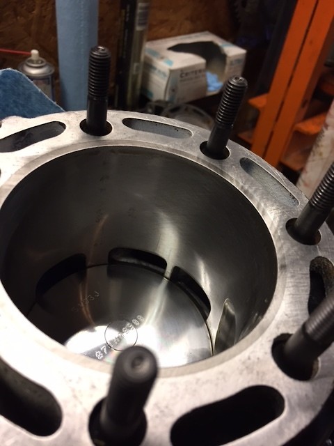

Cylinder head is a temporary setup, have all my specs. figuring on sending it to Gorr for decompression and dome volume and angle reshaping. I see a lot of info on this, however my piston protrudes above the cylinder surface.
Would love to find a spacer plate for the cylinder base, allowing me to have the cylinder flush with the deck and allowing the transfer ports to align properly, any input would be appreciated

Spacer Plates - I think you can get Cometic / Wiseco to make them for you.
But , if you've got a garage, with a vice, a drill, a bandsaw - heck, just a hacksaw, and some files, it's not hard to make your own with some aluminium sheet / plate.
