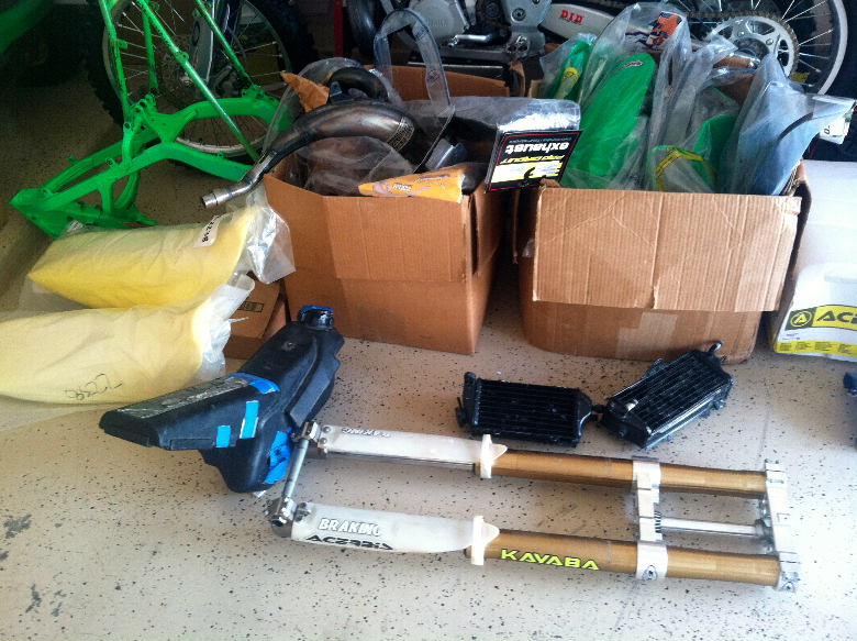

I brought home a pretty rare find this weekend that I thought I'd show y'all. The bike is nothing special, it's just a 98 KX250 with the standard mismatched plastic. It's the parts that came with the bike that I couldn't pass up.
Jeff Emig's Works factory forks, works factory larger capacity fuel tank, works chain guide, and works Nippon Denso radiators. He said that he couldn't get the Mg clamps because they were fatigued and they wouldn't let them go. He had Emig Racing build a set of billet Alum. clamps custom for the larger works forks. Also two sets of rare Flo green plastic that Team Kawasaki used from 96 on.
It also came with just about everything else you would need to build a really trick replica. Works connection skid plate and case guard, new excel rims and stainless spokes with aluminum nipples, Wiseco piston kit, Crank kit and clutch basket and clutch cover, New Pro Circuit pipe / silencer, throttle tube, Ti Pegs and clutch perch, new cables, pivot works swingarm and linkage bearings, seat foam and purple cover, Boyesen clutch and ignition covers, Boyesen Water Pump, New Chain and Sprockets and buffer, and and bunch of other small stuff.
I'm not much of a Kawasaki guy, but how often do you get the chance to buy works parts? If someone here would like to buy it for a project let me know at: flesche917@hotmail.com. Otherwise, I'm going to weld tabs for the skid plate and case guard to the frame before powder coating it Flo Green and building a replica of this bike:

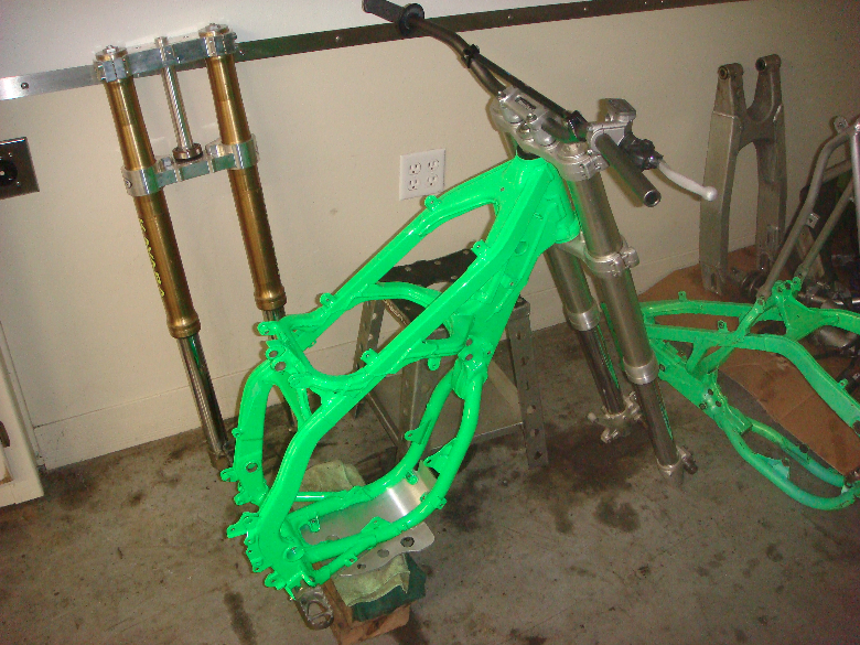

The brackets for the skid plate and case guard are welded on and some of the existing welds redone.
The frame is ready now so I shipped it off for powder coat and should get it back soon.

Finally got to work on the KX again after getting the frame back from Powder Coat. It looks really bright, almost glow in the dark. It is a little lighter than the plastic but it will probably match well outside. Looking at the Factory and PC KX's, the frames looked lighter than the plastic too. It's got to be right as I sent it to the same place they used.
I put the skid plate, case guard, and stock clamps and forks on for now as I'm not sure if I'm going to use those works parts or not. I like how Kawasaki started using rubber mounted and one piece top bar mount on this 98 model. I thought the larger works forks and billet Emig Racing clamps would be much heavier, but they actually weigh the same as the stock forks and cast clamps at 26 lbs. I got a current CRF front brake master cylinder and caliper to replace the weak KX setup. Also a set of new Renthal 971's and those trick PC cast Ti Pegs.
Next up, start on the swingarm and linkage.

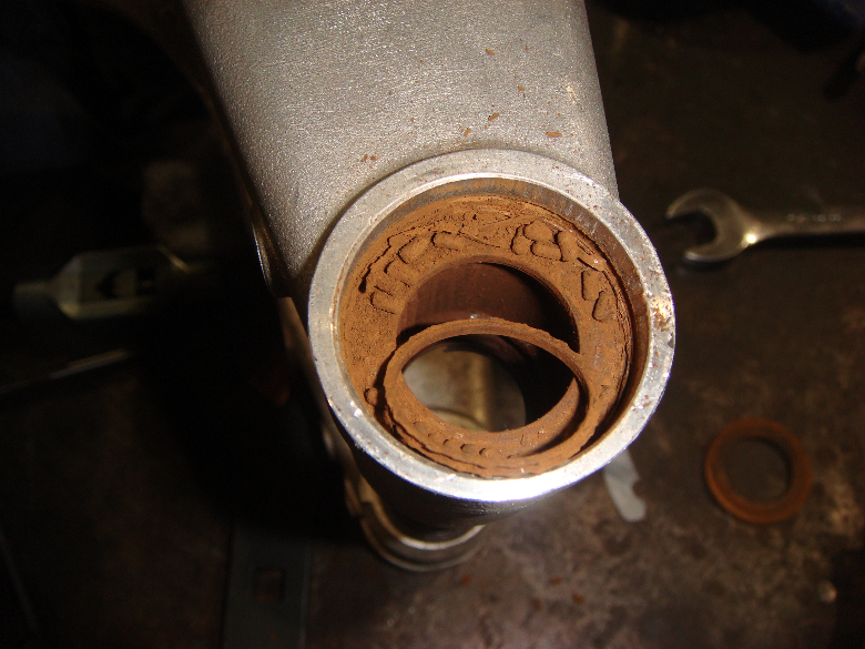

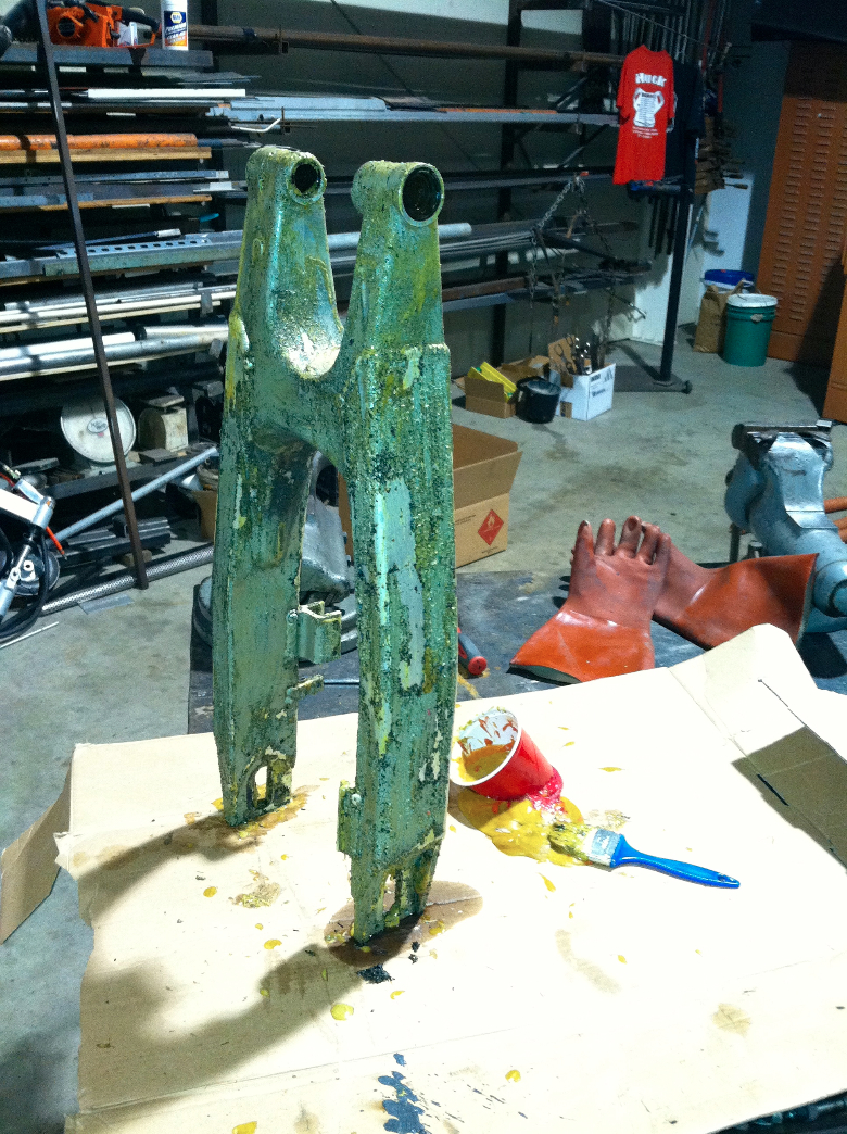

I started on the swingarm. It looked worse than it really was because of the black primer/silver paint that Kawasaki put on their swing arms. It seems like a shortcut compared to anodizing them like Honda.
I used aircraft paint stripper which worked great, but man that stuff is caustic...check out the cup in the pic! Looks pretty good now, but the surface is going to take a little elbow grease to get that brushed aluminum finish like the factory bikes.
Lack of grease in the swingarm bearings is definitely evident.
I pressed in a new Pivot Works bearings kit so it will be as good as new.
Next up is the linkage bearings which are about as bad as the swingarm.

Wow those are about the worst bearings I have ever seen. Unreal neglect

Not a lot of updates but I have found some additional works parts pictured below. I will probably end up selling most of the SR parts and still build a Pro Circuit bike which wouldn't use most of this stuff.
I was concerned about using those works forks as the brake carrier mounts are much closer together than stock. I would have had to have one made to accept a stock caliper. I was lucky to find a works SR front caliper and Magnesium carrier setup.
I also found a magnesium right side case, water pump cover, clutch cover and a the carbon clutch cover.
I already have the cast Ti PC pegs but I have a set of the works Kawi Ti pegs as well.
I have the 25mm works Ti rear axle and a front axle.
The Billet rear brake carrier is for an earlier KX circa 1994
The clamps are Emig racing from Team Pro Circuit 1998.
I found out the radiators, large capacity fuel tank/seat setup is off the Jan De Groot Kawi team from when Sebastien Tortelli and Fredric Bolley rode there in 1996 (125 World Title for Tortelli)
