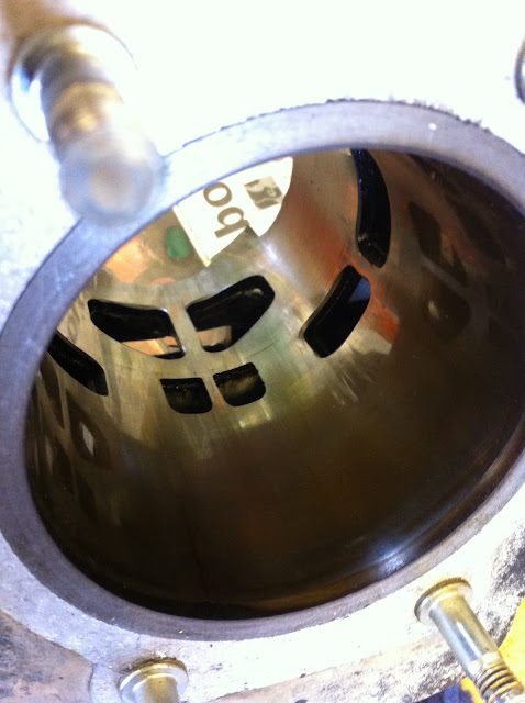

I peeked in the cylinder when i took off the exhaust and the piston seems to be in great shape, there was a thin oil film covering the piston, amazing after 23 years.
A bit of magnesium corrosion

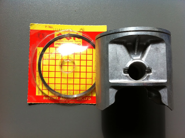

New piston & ring, NOS.
Not too much carbon buildup.

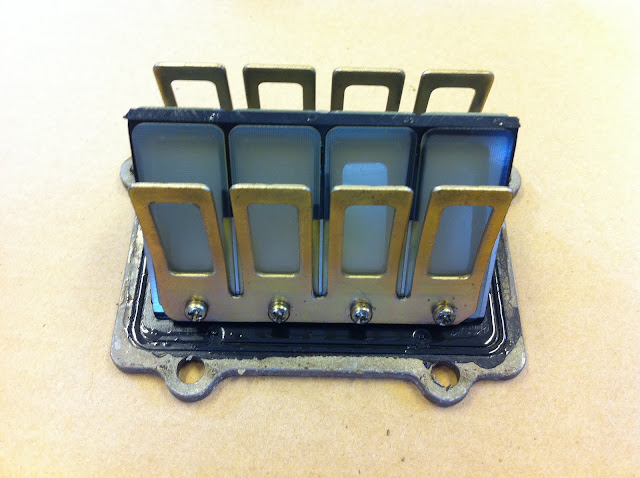

Reeds look fine.

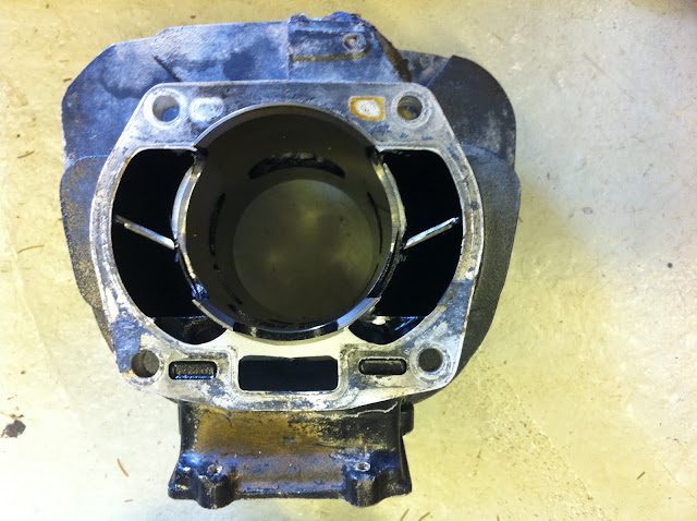

The head.
Couldn't feel any edge where the piston turns.

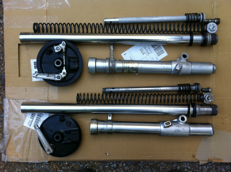

Anyway, i scored a set of 1984 forks and DLS brakes and wheel.
So here you can see the difference between the 82 forks and the 84 forks.
