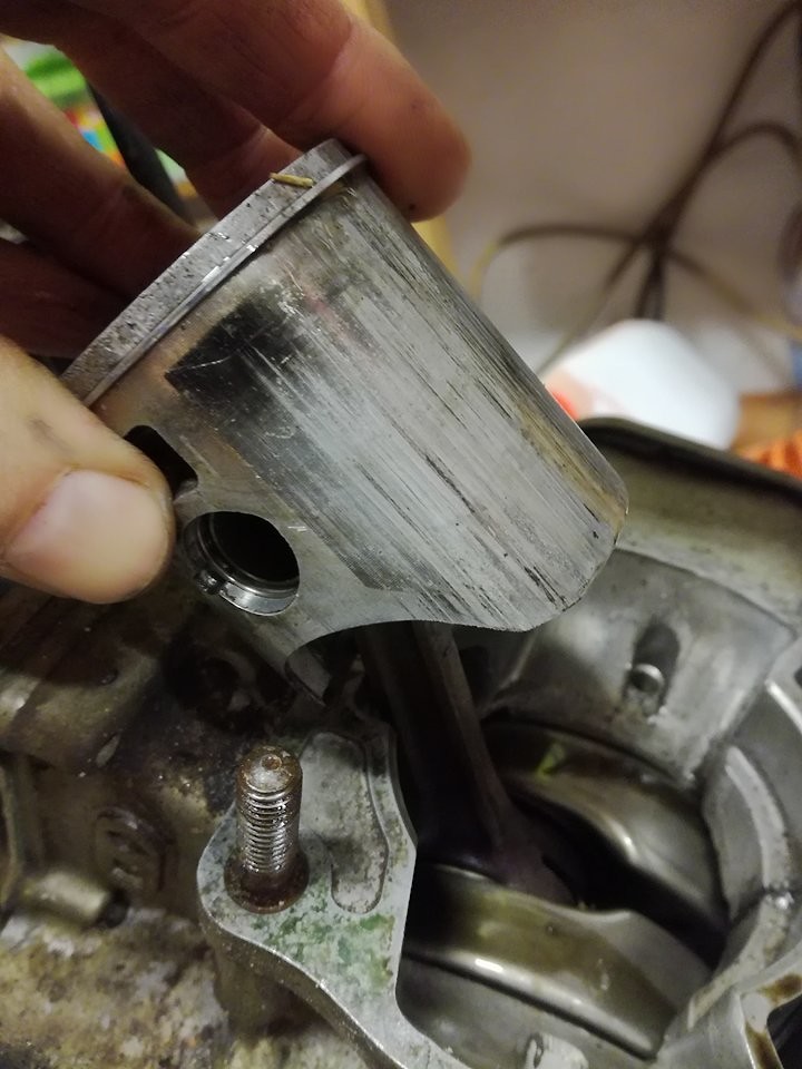

I started By pulling the 95 apart, I knew the piston was damaged, but no clue how, it looked like this:
Cylinder was like this:
looks quit ported to me
The former owner told me the exhaust valve was missing, actually just the cenrifugal unit that drives it was, but the arm that is betwen the centrifugal unit and cylinder is damaged, the splinse/gear is broken. The clutch cover has a weard weld jobb done:
