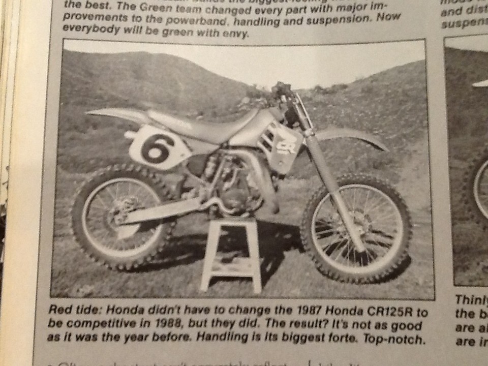

Bent206
133
10/1/2016
Coventry, RI US
5/16/2020 4:22am
The frames are nearly identical. The ‘88 has gussets at the swingarm pivot that the ‘87 does not.
You can just make out the gusset behind the brake pedal return spring.
‘88 pictured.
