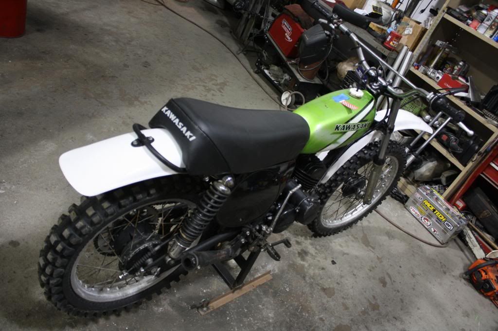

Nothing new on my '94. I want to setup the suspension for sure. but I'm not going to ride the bike alot so that's on the back burner. I've been modding my 76 KX125. I gained an inch on height and some travel, made up a modern chain guide system too. http://i114.photobucket.com/albums/n248/Jeekinz/76%20KX125/IMG_6595.jpg

nice work on the 76 model, it looks really good and must handle a bit better now after your mods.
