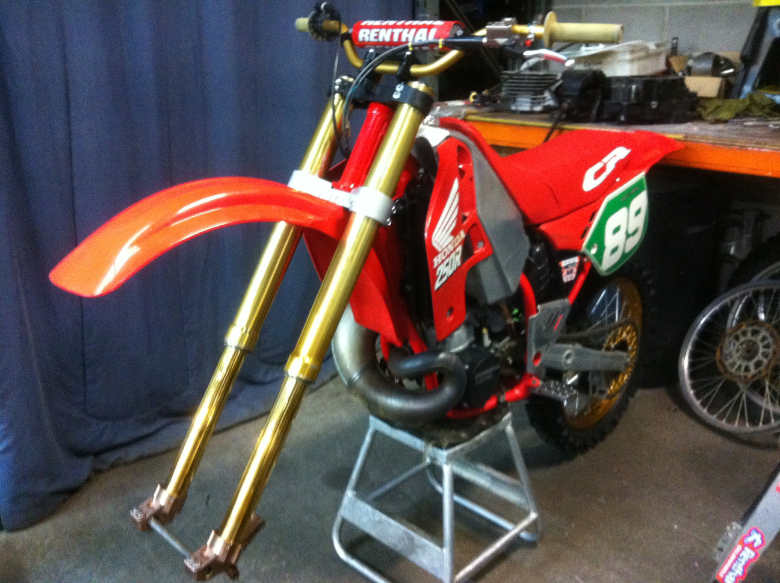

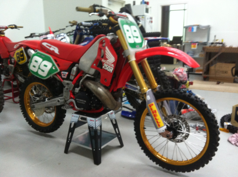

Hi all, I am new to this forum and just bought a 1993 CR250 to resto as a 1996 MC replica too. Great info here thanx to all you members !
Regarding triple clamps, I have had great success mounting French brand SCAR triple clamps to my 1989 CR250R with Ohlins forks, see pics.
These clamps actually fit 1997 to 2007 CR125/ 250 two strokes so 47mm standard Honda Showa forks will bolt straight in. The stock steering stops even lined up very well with the stock frame steering stop without modification. These clamps come red anodized which I had stripped off and I re anodized the top clamp and bar mounts black and the bottom clamp natural for the 89 HRC look. The top clamp needed minimal material machined out of it to mount up properly, the machining is underneath so it's not visible at all.
I will be trying to fit a set of these clamps to the 93 model CR250 I just bought.
The best part is that these SCAR clamps retail for only AU$449.99 for the complete top and bottom set including Pre pressed stem and lower bearing here: www.shop100mx.com
I understand from personal experience that the steering stem length is shorter on the '89 and '93 than the '96 and up. How did you address this? Also, the bearing changed in '93, so if you have the larger bearing that would come with clamps for a '97-'07, how did you address this?
Did you send them your '89 stem and have them press this in with the correct '89 bearing?
What did you have removed?

I used the stock 1989 stem, yes it is shorter so we had to change the thickness of the top lock nut on the bearing underneath the top triple clamp, we used an XR400 top nut here as it is thinner than the stock 89 CR250 lock nut. The thread is shorter through the top clamp nut but still plenty of thread to bolt it down nicely, see pic.
The stock steering locks on the triple clamps lined up nicely with the stock frame mounted steering stop, see in pic.
We used a new bearing with the correct ID to fit the stock stem and the correct OD to fit the SCAR clamps, this was a common bearing from a bearing supplier, nothing special.
Underneath the top clamp we had to machine a couple of mm's of alloy of so that it cleared the locknut and slid down closer on the bearing, see pics attached.
The bike is now finished !
