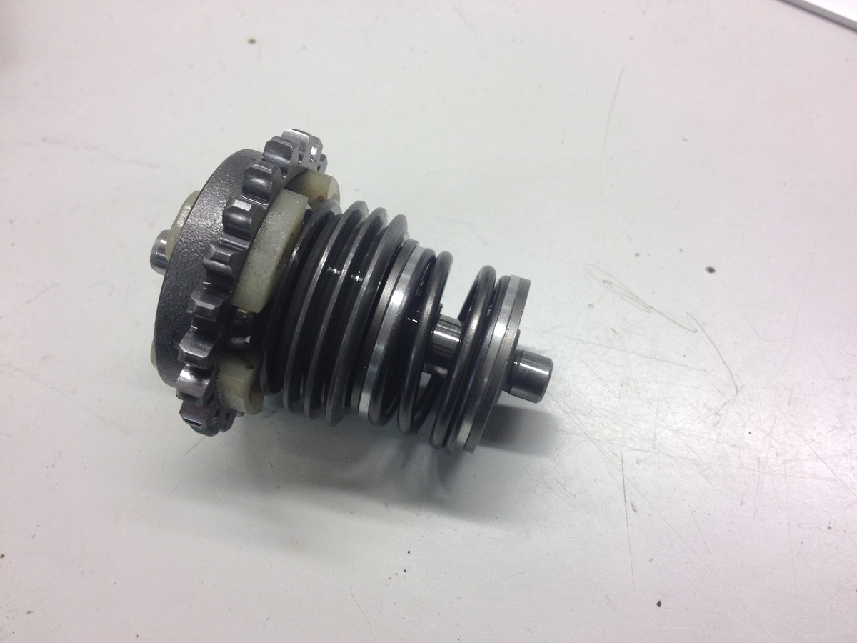

When you say you still use stock carburetor and stock valves i can tell you that you miss a whole lot of ponies hidden in there.
A bigger 38mm carb let's it breathe a lot better and adds a healthy dose especially mid-top. I also tried a modern PWK Air Striker carburetor everyone raves about but i still haven't found a carburetion that can match the performance of my 23 year old Keihin PJ Wink However with bigger 38mm carbs i noted a slight hesitation right around the moment you enter the powerband. Not really a bog but really just a hesitation. I was able to get rid of it though by having the HPP a little later by adding a little preload to the governor down in the engine. This makes for a much more linear powerband.
HPP governor with the two shims that get added:
Modified HPP governor with added preload for later opening of the valves:
You can also change opening timing by installing those adjustable HPP covers by Wirtz or HPR. But those springs are a little weak and only allow for smaller changes but this way it's done easily on the track:
