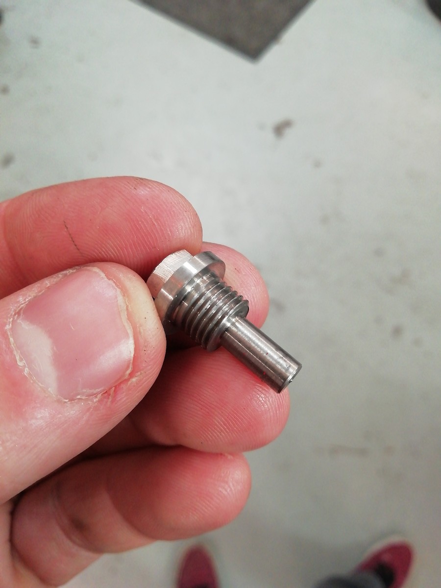

Digging up a thread looking for info. I have an 86 cr250. Trying to put the power valve back together. I believe I have all the parts except the sealing bolt on the rack.
Does anyone know the length of that bolt so maybe I can put a generic bolt in for the correct spacing ?

I've got the same problem. Bought the bike with it missing. I guess it was run that way. Yesterday I ground the threads off the bottom of a bolt and threaded it in. I assume it will work until I can find one. What did you end up doing?

I'm guessing you guys need the LH side bolt with the extended "nose"? The one you need to swap over to the RH side to set the valves and rack in the correct position?
They are no problems at all! We do them in both Stainless and Titanium, depends which you prefer. If you msg us via FB or email the 'shop we can get you sorted.
The one pictured, I had to make with a bigger (M9) thread as the M8 threads in the RH adjuster side, had stripped out of the barrel, so the STD thread LH bolt wouldn't work. That's why it not finished properly. It only gets used for setting the valves up then it's back in the tool box. Our "production" ones come with either dished or HRC style "flat" heads.

That's the one I'm looking for. Does it serve any function other than to plug that end of the rack? Mine didn't have one when I bought it and Millennium did a replate and HPP service, so I assume it adjusted up fine without it. Will email PDE to get more info. Thanks
