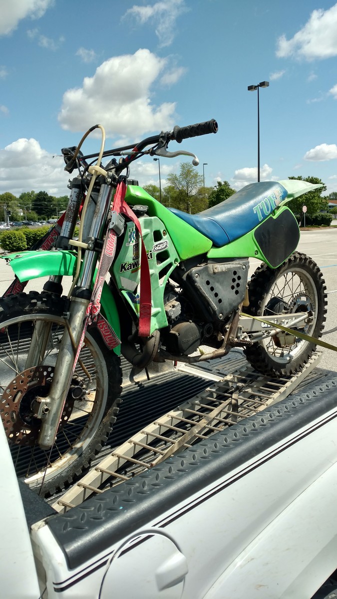

1985 KX125

Literal dream bike there smile I got into mx at 12 years old in 1985, just as the 85 models were coming out, and the kx line and the ads for them burned into my memory. Great job!
9/18/2017 7:01 PM
Are those later model forks?
9/18/2017 7:09 PM
Forks are from a 89
9/18/2017 7:10 PM
Maybe it was 87, sorry
9/19/2017 12:46 AM
Nice work. Was the cylinder already ported by TUF? How does it run?
Are you sure the forks are from an 87? I was thinking they didn't get a dual piston caliper until 89
9/19/2017 5:05 AM
I could not remember which bike I took the forks from 89 sounds right. I have parts from a few years on the build. I even put a part on from my old 82 KX125 that I still had. It's a 82,85,87,89 kx125

I may have thrown the seat cover away. I will look in a few minutes. The fork and clamps went right on but I may need to take them off at some point and add to the steering stop on the frame, the forks will hit the gas tank slightly. I have only rode in the yard so far so I don't know a lot about the porting yet, track time next week I hope.

Eric Gore actually did TUFF porting back in the day. Is there any engravings in your cylinder?
Mine current one is still bone stock and runs well. Suspension is stock and soft. So I picked up a newer YZ 4.9K Titanium spring that should fit on back. For front I have 88 43mm forks, and the complete 46 front end I hoped would work.
Adding to your stops to limit triple shouldn't be hard...maybe done right on the bike with a TIG welder or MIG, build up a couple spots.

Yes,there isPhoto
9/19/2017 7:11 PM
How was the porting done ? More top end or mid, bottom end ? I should find out soon but just curious.
9/20/2017 6:42 AM
Jon ,I had Eric port for "top end" and had a pipe with Eric's jetting recommended. I don't remember the brand of pipe but it was mostly top end for sure.

Back in the day..1986 when I freshened the '85 KX125 with TUF seat cover bike,,I remember raising the exhaust port a small amount...020" and that made it hit harder up top. Gave the feeling it was faster with harder hit...but the other '85 was done by Barr Comp in (NC I believe) and it was faster and easier to ride with wider powerband. Both used stock pipes and carbs.
9/20/2017 8:49 AM
I'm getting old and slow, so if it has something on the bottom to mid range I will be happy. I just got back into racing after a 30 year break.

You may have to swap and mess with shock collars to fit the KX shock
I remember the YZ TI shock being a larger ID
And clearance against the air boot may be close
9/26/2017 11:22 AM
riv187 wrote:
Thanks please save that cover if you find it,,,,I have had the logos copied and stencils made many times to make my own covers ...more
And ...more
Yes I may have to use a collar on shock spring. When I compared specs it was about 1-2mm different at base coil. Small amount and may not create any problem,,will see! thanks!

I raced it on Saturday. I need more time to get the suspension set and I need some jetting help, but it will be a fun bike. Any good jetting info available ?
10/2/2017 7:28 PM
My bike is bone stock currently.....and runs stock jetting with 32-1 race gas and b8es plug. I'm a porky 140lbs and still the stock suspension felt like a soft couch. I added air to front and preload twisted caps all the way in and added compression to rear to make it through race day.
10/3/2017 2:20 PM
I may try a B8 I just bought the stock B10 to start with. I have 35 pounds on you but I sprung it for that.
