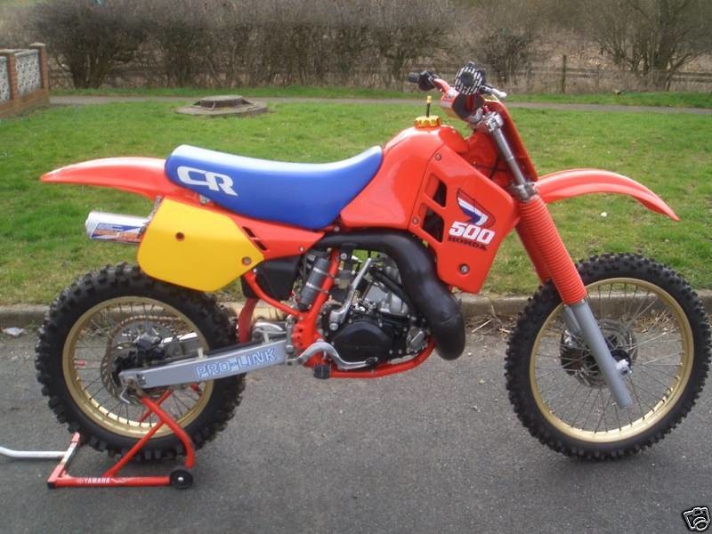

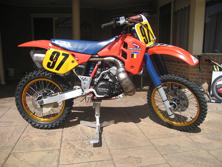

Here's a couple of 87 500s - both with different levers. Their pipe / tank layout is similar to the 85s, I think.
One has a 88/2001 KS lever on it, with, it looks like, the 'fold in' stop modified, which would require also the 'folded in' detente ball re-location, for no rattling / free movement.
The other looks to have the early CRF450 type of lever : PhotoPhoto

Interesting tank/seat on #97, Looks great, Trying to figure out what it's off ??
Perhaps the lower bike has a 250 (or 125) tank on it?, That, and the thinner, flatter seat , thence to tank, and other mods, makes it look very bloody 'purposeful', I reckon.
I think I've seen some build ups ( at least one here) where a fellow used a 250 tank, for it's slimmer size. Though, I do think that the bike above it, with what looks like ( to me) a Larger accessory tank might over emphasize it all, in that seems to dwarf the lower one. I'm not really 'up' on the nuances of the earlier Water Cooled 500s
One advantage , for me, when I used a CRF450 KS, was how it , when swung out, had the lever further out from the bike. Easier for me with my buggered knees to get my foot on, and then kick it through.
Here's a picture of the Gas Gas lever I made to fit. With a very long foot section, to keep my foot on the lever no matter what. Short KS lever foot sections, are nasty bloody things. Especially on a 500. Each 'slip' of my foot off a lever, I reckon took a few final rides from me, it so damages my knee. The rubber glued and cable tied on, also lessened the metal to metal hit on the peg, that also, I reckon, would take a few extra final rides from me. With the Automatic Decompressor I fitted, and the short length of the lever ( more 'speed' to the lever throw through the short arc of the lever ), I can start the bike by hand, if my knees become even more kaput during a ride, or I am stuck in a tight spot where you can't get a kick in. I just carry a machined tube, with a soft Oury grip on it, that fits nicely on the lever. I've an E Start kit now, but it's a POS that I've had to rectify many problems with, and I regard it as a potential engine destroyer. I rarely ever use the bodgy bloody thing, only fitting it when I cannot use my leg. A waste / rip off of near $3000 AUD........
You do whatever you have to do, to keep on riding., boys.
With the picture below, keen eyed individuals might note some other substantial differences of my 500 to others....... Please note - I use plastics from a 90 /91 model I had, as I ride in very tight, nasty terrain. They are torn up very thoroughly after 27 /28 years abuse on a few 500s. And the airbox, with that horrible decal on it, is Not an airbox at all now - it's just a shell with an aluminium airbox I made, inside it, with a top mount airfilter to allow use of the PDS system I converted it to . I've an Otto bin full a Lot of new plastics (and the standard, non molested Swingarm, Linkage, Shock, Airbox and Subframe), that will probably only be used when the bike becomes a 'Garage Queen'. Hopefully, that's a fair few years away. This is one of my Keep Forever / Ride Forever bikes.

Hi, the #97 500 is mine, it’s a CRF Kickstarter but I’ve replaced that now with a 2003 CR250 one cause the CRF one cracked through the spline. The pipe is an ‘89FMF that I sectioned to wrap up higher to give clearance for the different kickstarters, the standard ones are so awkward to kick being so close to the frame, & mine is not easy to start! The tank is a alloy one that I made and the seat is just a ceet tall foam. I straightened the top subframe rails to lift the middle of the seat to make it flatter. Also I lengthened the shock too just steepen up the steering abit too and it runs applied triple clamps of a 2009 CRF250 to move the bar mounts forward. Its all stripped down now at the moment getting a tidy up for next season (it’s pretty much been like that for 6 or 7 years now). We race in a vintage club over here in NSW Australia, afew mates have got ‘89 CR500, a KX500 & a KTM500, best bikes too ride. Photo
12/24/2018 3:08 PM
Also the kickstarter on the top bike is off an '88 500 and thats how they fold in normally too, mine had one when i got it even though it's an '87 model. Pretty sure that was a one off year for that kickstarter too. '87's had the same lever as '85 & '86 I think.
Hey Lardcaster, Have you tried any other year of Cr250 kickstart levers or did the 03 fit the best? I have a 08 Crf450X lever on mine at the moment and it works ok. Just wondering if I go the Cr250 lever? Thanks.
12/25/2018 4:39 AM
Edited Date/Time: 12/25/2018 4:40 AM
I have tried gen 3 250 kick start levers on my 500AFs in the past, but they would break at the knuckle. I have more compression than stock. With a decompression device it would work though.
ps. I love that bike!!!!
12/29/2018 2:31 AM
Yeah I tried the kickstarter of my 97 250 which was ok but the ‘03 seems the best. I’ve had it on for about 2 years and fingers crossed it hasn’t broke yet. The pipe on mine is custom so these kickstarters will fit, I don’t think they will tuck in properly with a stock or even aftermarket pipe.
