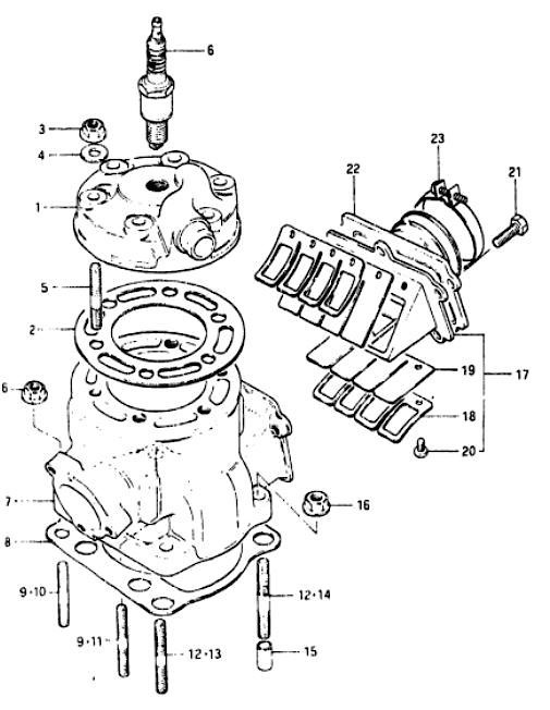

Does anyone know if the 1982 RM250 used an intake gasket?
It's not shown on the parts list. Seems odd not to have one between the reed block and cylinder.

1/3/2018 6:45pm
I can take a look at my 82 tommorow, but there is not a gasket on my 81 and it's the same setup. What's funny is that, it appears Suzuki did not start using a gasket until about 1987 and the Reed setups are pretty much the same...I surface the Reed area on the cylinder before assembly.
Bent206
133
10/1/2016
Coventry, RI US
1/5/2018 6:06am
sandman768 wrote:
I can take a look at my 82 tommorow, but there is not a gasket on my 81 and it's the same setup. What's funny is...
"I surface the Reed area on the cylinder before assembly"
Thanks for the information. I'll do the same.
